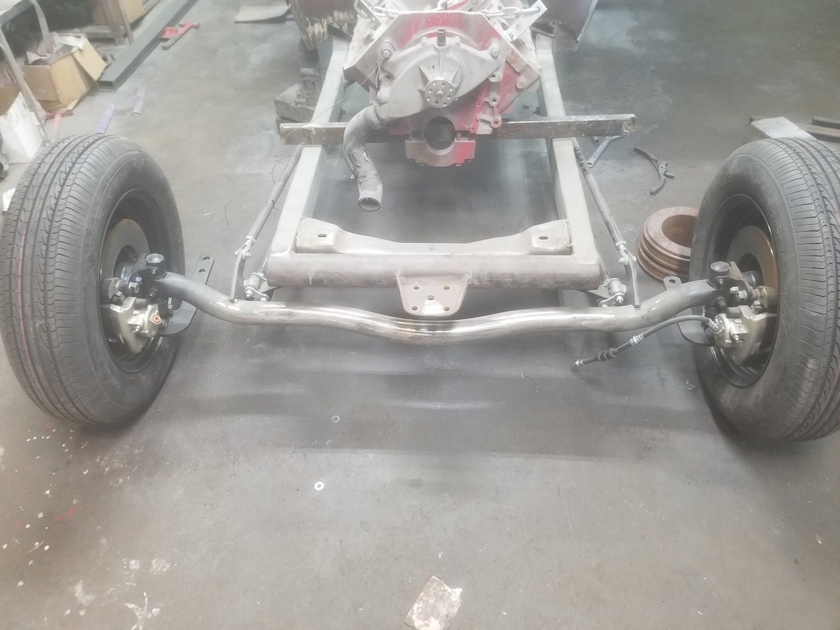

    I put a mopar wavy axle under the front of my plymouth 33 project, transverse spring behind axle with a model A crossmember and hair pins. I put new king pins and bushings in, everything is good and tight. My problem, tires are leaning in at the top, negative camber, my question is, is there anyway I might have installed the spindles on opposite sides? I wouldn't think it'd cause this, the steering arms bolt at the bottom of the spindle, the stops are in the front. It was apart for a long time, had them marked but some where along the line the marks are gone. Maybe it was that way to start with, I don't know but before I go to heating and bending thought I'd ask. Any other ideas on me screwing it up another way?!

    I don't really know how many degrees, I need to find a gauge that goes on the center of the hub like dirt trackers use. I guess I could put a straight edge, level maybe, and use an angle finder and get an idea. I'll try and get some pics.
  5. Mike Colemire
    Joined: May 18, 2013
    Posts: 1,431
    Mike Colemire
    Just using an angle finder it looks like they are 5 degrees in at the top.

    Knee jerk reaction... wrong spindles.

    They were the spindles that came with the axle and they had been on there for years.

    If you didn't have that camber before, using the same parts** other then pins,you must of rolled over/upside down, the spindles ? Or the axle is bent in center? If not they wrong already some how

    Are the spindles right side up?

    I would think so, the spindles have 2 1/2 inch holes on the bottom for the steering arms to bolt to, upper holes are a lot smaller. The stops are on the front and serve to hold the king pin also, they are threaded. The only thing I could think of is I could have switched sides but I don't see that causing this. There is no damage or dents in the axle.

    If spindles were upside down, it would be off many degrees. Are you sure the spindles had a good alignment before? Just because they were already on it doesn't mean they had a good camber. Maybe somebody just threw some Mopar spindles on the axle that had the same size kingpins. I know that some early Fomoco products had spindles that looked the same, but had different inclinations.

    Hard to tell in the picture; was more stuff cut off the axle than the original spring saddles? Heat possibly could have pulled the tube. I'd pull the wheels and hubs off, level it across the top of the spindles, and get an accurate measure of the camber off the face of the spindle on both sides. Once armed with that info, should be able to tweak the axle back in compliance on a press. Looks like you batwing brackets are just tacked; maybe finish the welding, that could pull the tube around too.

    What happens to the camber if you roll the axle backward to give it more caster? Does the camber improve?
  25. Mike Colemire
    Posts: 1,431
    Mike Colemire
    No, I went both ways, no change. In the pic it's at 6.5 degrees tilted back.

    If it was mine I would pull the spindles and get the ends of the axle on top of the king pin bosses as close to the same angle- if one reads 8* you want the other one to read the same with your angle finder. If they are at least close that will at least give you an idea of the king pin boss angle.
    Next check a spindle, with the stub axle level what does a king pin read? That is your KPI- king pin inclination.
    As an example, an 8* axle and 4* KPI will give the result you have. I still haven’t found the specs but I believe there are Mopar spindles like you have that have different KPI’s.

    The Dodge trucks had I beam axles just like in my '36 Dodge pickup. Cars had tube up through 1933, then '34 was independent, then back to tube in '35-'38. I'd have to say if the spindles were already on the axle and the stops are in the front, the axle is in backwards.

    Backwards/frontwards isn't going to affect camber. changing caster on that axle shouldn't change camber because it isn't the same as changing shims on an A arm or other independent suspension caster/camber adjustments where changing one changes the other.
    I can play with an axle I have clamped in one of those black and decker work stands tomorrow and stick one of ( or each of) my gauges on it but I'm positive that won't change.
    I'm still thinking that A a previous owner swapped spindles to have some that worked with better brakes or B the camber got changed by work someone did on the axle at one time or another. I could believe that more if it didn't match side to side though.
