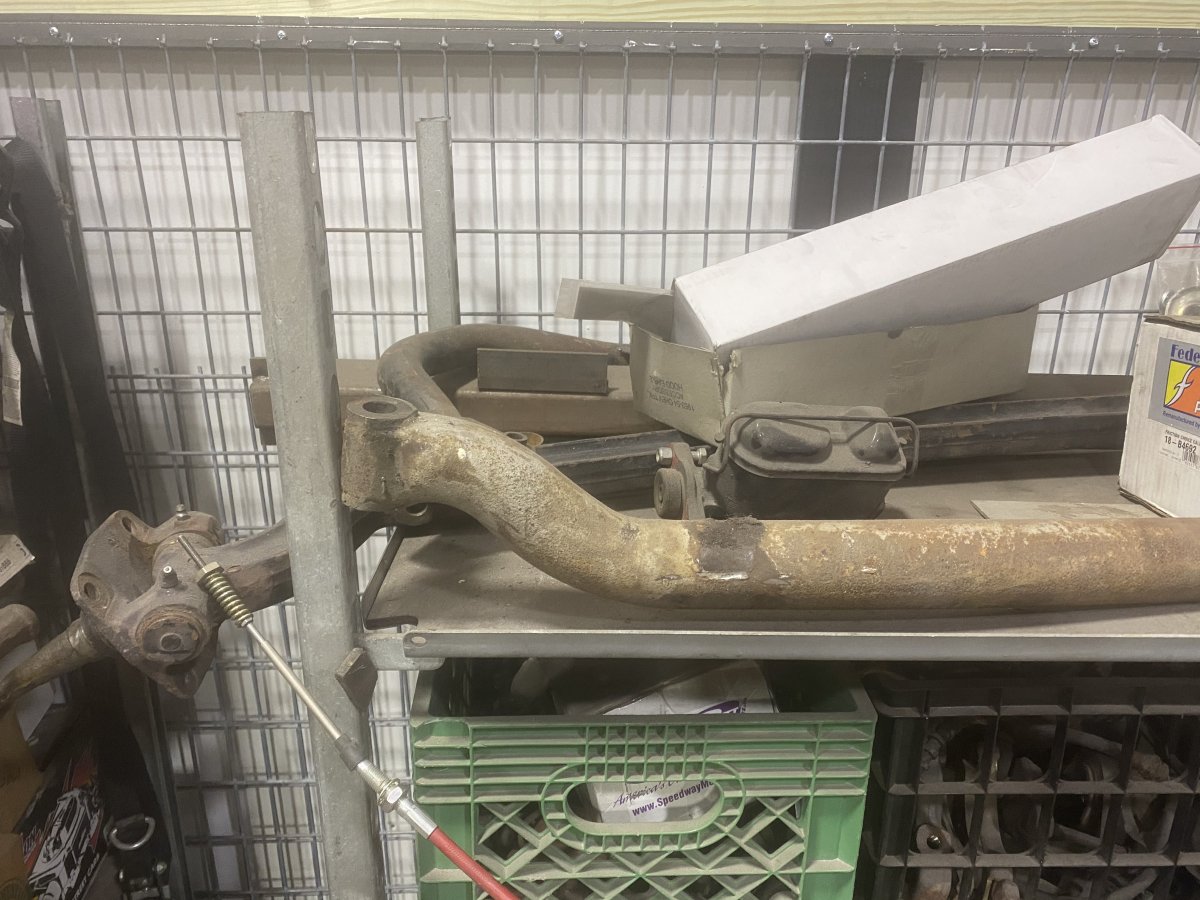

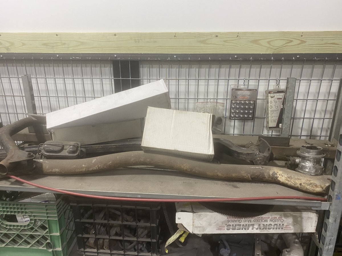

  12. if you need some dimensions let me know
    37A879FE-AD30-4C18-829C-0A642C84D920.jpeg 60BE2597-C88A-4EFC-95AA-0B5EEA500206.jpeg
