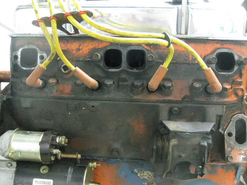

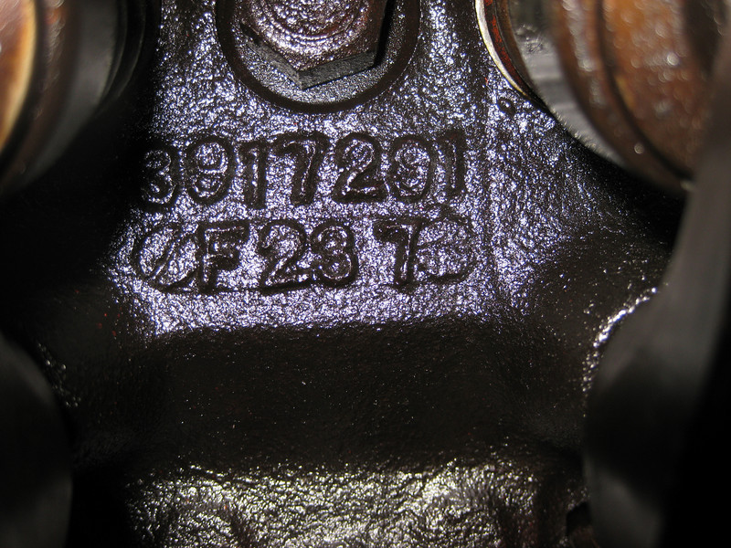

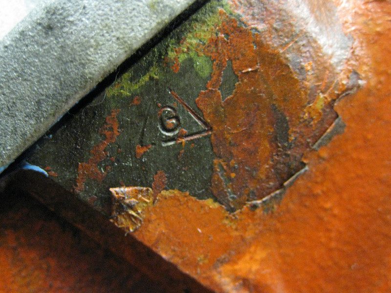

    Fred, thank you for all the helpful information! I just picked up a motor with a set of "291" heads. The entire casting number is 39171291. Is there any way to tell if these heads have 1.94/1.50 or 2.02/1.60 valves without removing them? Searching the net it looks like these are from a '67-'69 302, 327, or 350. I would love to narrow this down and determine what the came from to know exactly what I have. Is removing them the only way?
    FYI, the engine block code (V0306TJZ) looks to identify it as a '73 truck 350 so it looks like the heads were added later. I'd appreciate any info. you may be able to share.
    I'll attach a few pics of the heads.
    Thanks,
    Tommy

    The OP seems very knowledgeable but this info^^^ is wrong.
    Copied from elsewhere. This guy is correct. You can't tell a 461x head from the top side. There is no "X" under the valve cover. The x in 461x heads is cast in the under side of the head under the water p***age.
    "...461x heads were mostly 1.94,1.5 valves with some 2.02s the X was never in the cast # under the valve covers between the rocker studs but was cast on the under side of the water jackets on the intake side on the ends of the heads they do have 170cc intake runners and were the best factory heads in the early 60s(most were cast in 63-64,65, with some 62 66 date codes, they were The head to have in stock and super stock cl***es and came mostly on the hp corvette 327s with and without the Rochester FI but could be found in other models with hp 327(ss chevelles ,ss impalas and are highly sought after by collectors for restorations and by street stock roundy round racers. check out the ebay listings for original un modified 461x and most are getting well over $1,000 for them compared to $200-$500 for the other (461,462,186,ect.. )camel hump hp small block heads. one last thing they will support370-400 horse power even in 1.94 valve sizes, proper porting with 2.02s(attn.to un shrouding) will support 450+ and maxed out welding by a few elite porting gurus have gotten 600+ out of these ****ers and if you think i am wrong check out some of the NHRA records that still stand today with these heads
