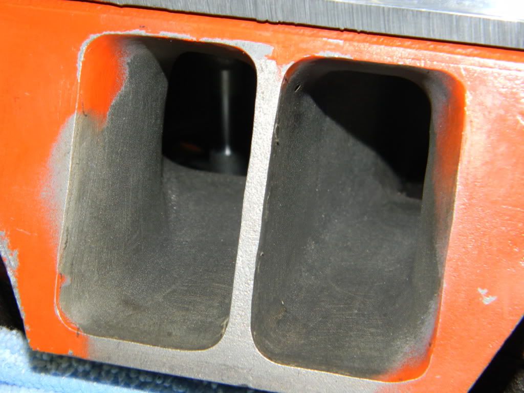

  20. After Market Camel Heads would be OK. if there weren't so many Original heads still around. I have this set of 194's nobody wants, fully ported. Good around town and plenty of power to spare.
