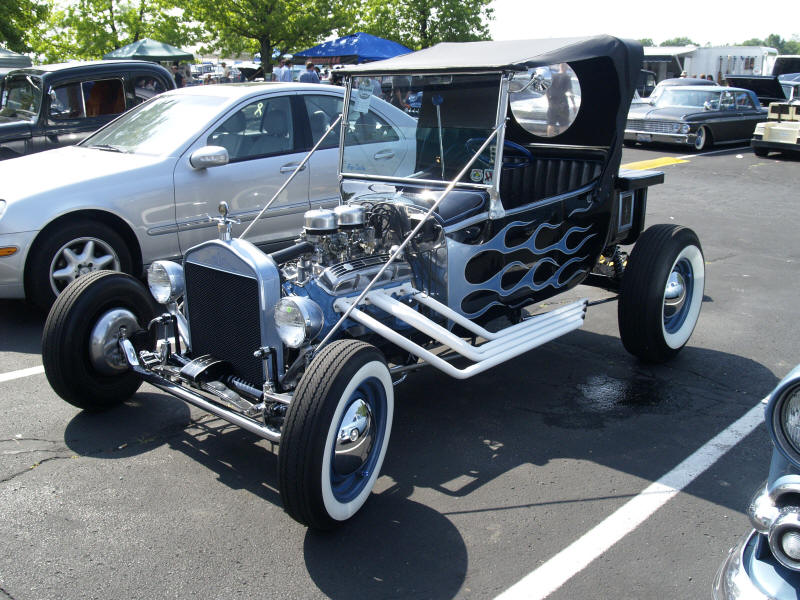

    Look real close you can see the humps! 1967 327
