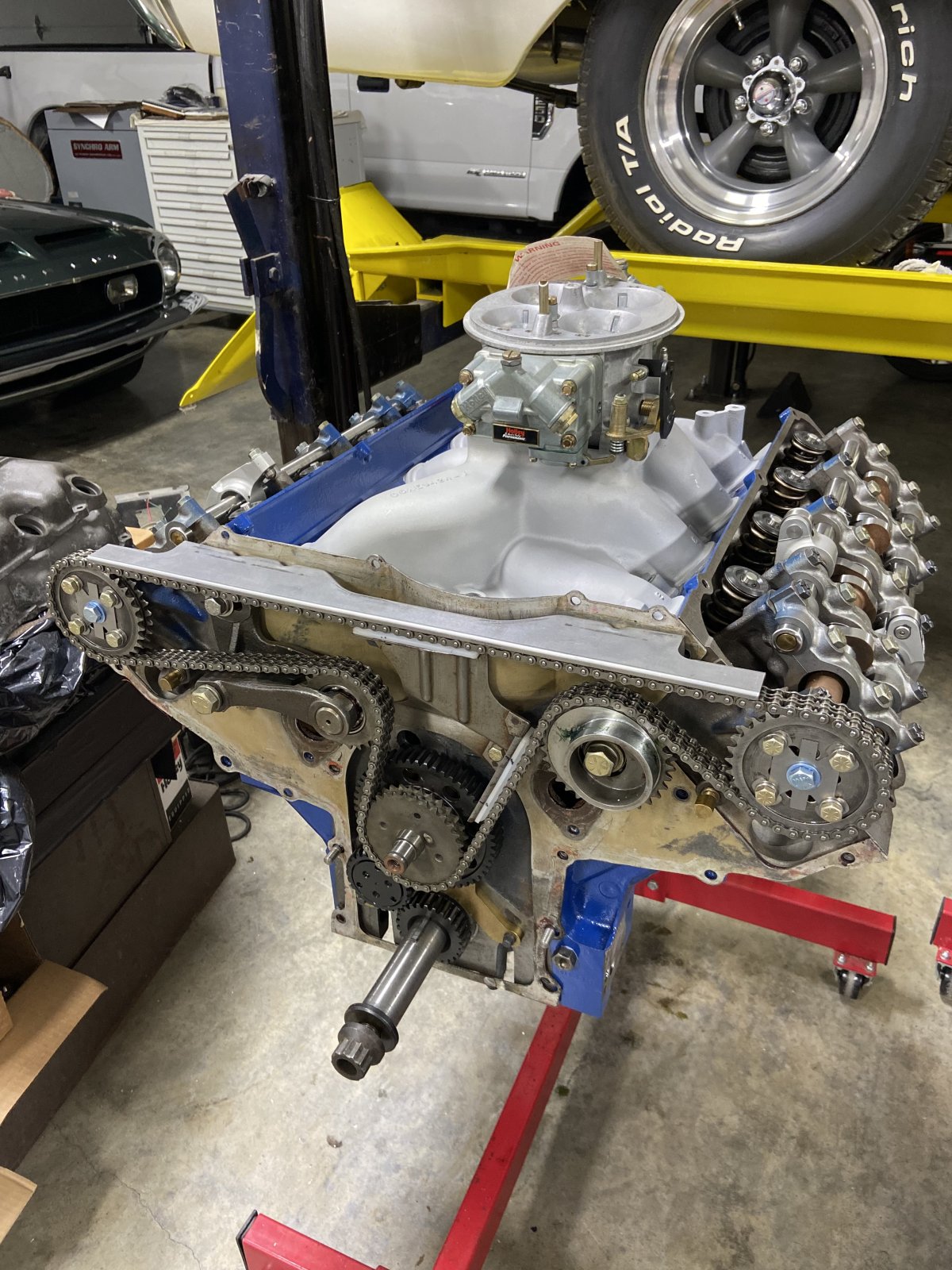

  12. Don Martin
    Joined: Nov 2, 2006
    Posts: 192
    Don Martin
    from West Tenn
    After 3 months of waiting the head gaskets arrived this week. Heads and intake installed. Working on the front now. 4C31C9BE-105F-408C-8B5A-6C58C4D0CB12.jpeg E8618591-AF67-463F-8287-EB4DCAB06EA1.jpeg 4C31C9BE-105F-408C-8B5A-6C58C4D0CB12.jpeg

  14. Don Martin
    Joined: Nov 2, 2006
    Posts: 192
    Don Martin
    from West Tenn
    Small steps this week. Got the Milodon gear drive installed. Drilled through both gears and installed a hardened pin. This is something the factory did not do. This will keep everything in time. E7A02DC7-E201-4D42-9E59-C4030DE9810C.jpeg

  17. Don Martin
    Joined: Nov 2, 2006
    Posts: 192
    Don Martin
    from West Tenn
    BBA05703-0347-4F4E-B552-A30346D04515.jpeg Cams arrived this week. Final ***embly is underway.
