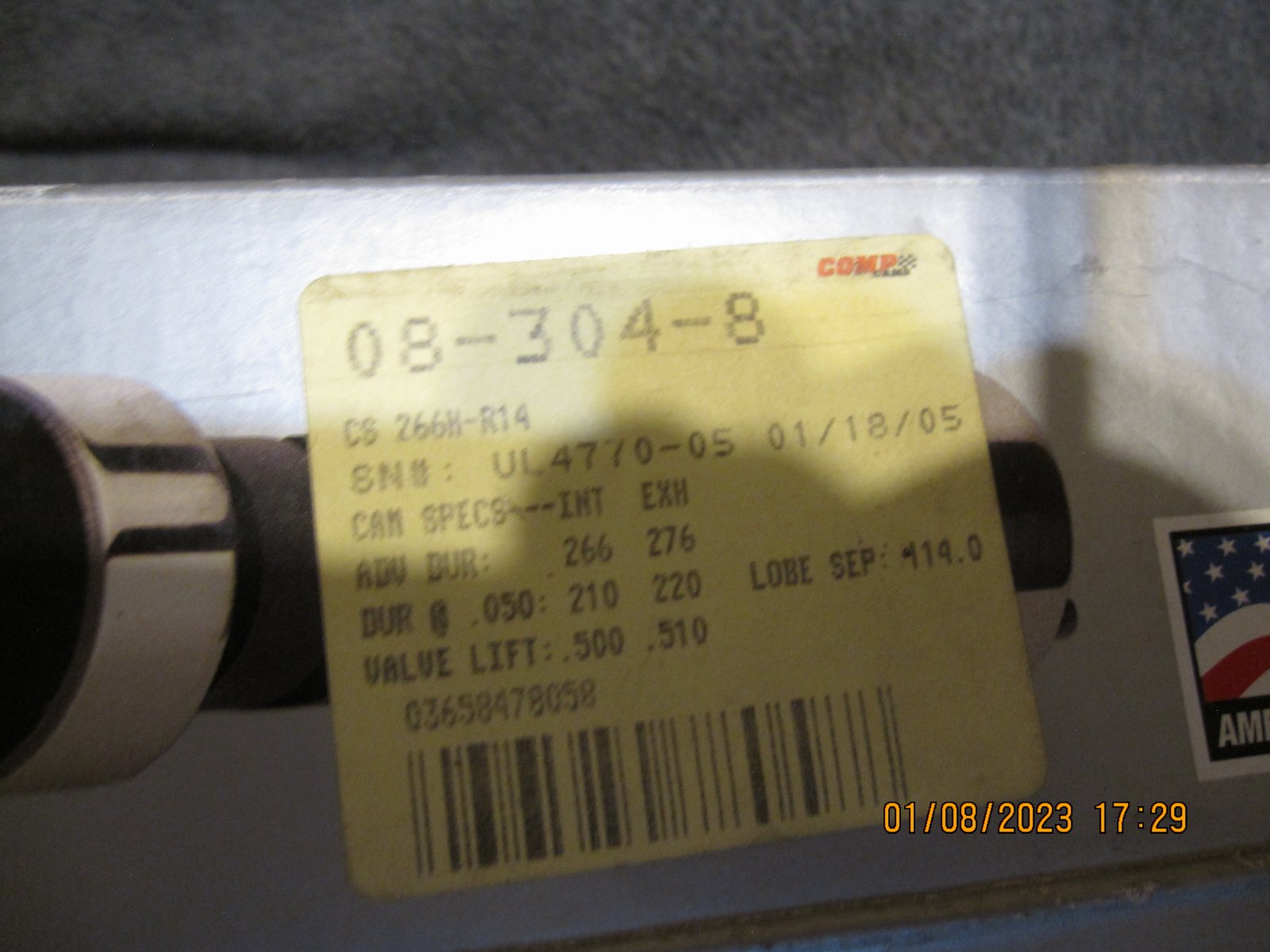

    Had a 351-W built for my 55 Sunliner years ago that I specified a RV grind,well I figured out that it did not have one since it really started to come alive most likely above 2500 (no tach just guessing) and did not like the tall gears I had installed. From day one it had issues with the trans shifting into third and after four trans I decided to put a stock cam in and now it shifts like it should,I knew with in a year of driving it that the cam most likely was not what I ordered and had been planning on changing it but put it off since the engine ran good and have since got most of the parts to go back to a Y block thinking the engine was most likely built with miss matched parts. Of course no numbers stamped on the cam to tell just what it is but today is the first time I really had it out since the cam change and way better then it ever had so are there cams made that really should not be used with a automatic trans as I think I got one.

    It was supposed to be a RV grind but doubt it and was a cam the builder had in stock,the trans shifts much better and has a smoother idle plus the low end torque seems to have improved so all I know it's not what I wanted and I now have the correct firing order. Much happier now but it will be going back to a Y block in a couple years and that cam that was installed really did not like working with a automatic trans.
