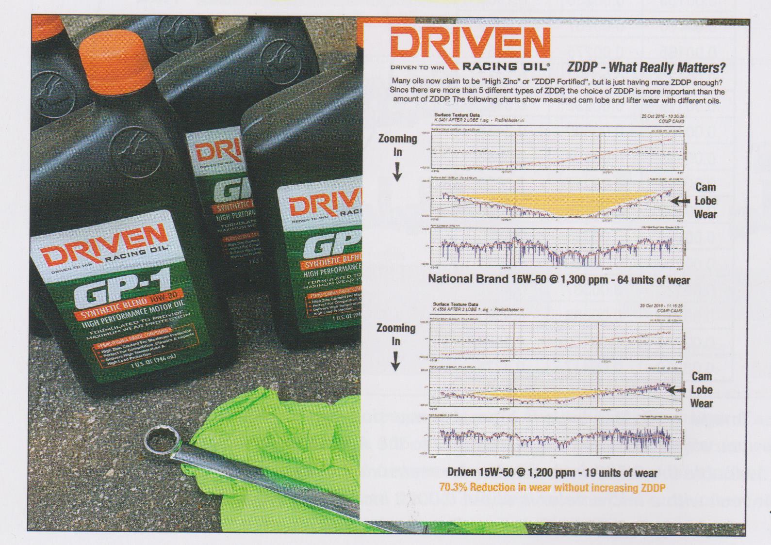

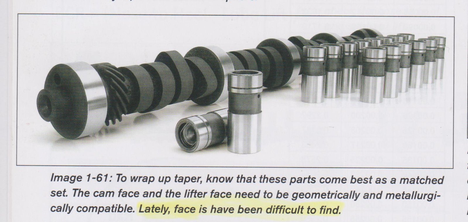

    @ekimneirbo thank you for posting the additional technical resources here. Although I am certainly aware of who Billy Godbold is, I did not know about this book. Now that I do, I would like to get a copy and see what more I can learn from it. I can't say I'll be any better than you at understanding some of this stuff as it can get pretty deep.
    Much of what is written in pages you posted does seem to back up the independent testing I have seen.
    The overseas material quality issues have been a big problem in many industries for quite some time now. I saw it first hand while working for my previous employer.
