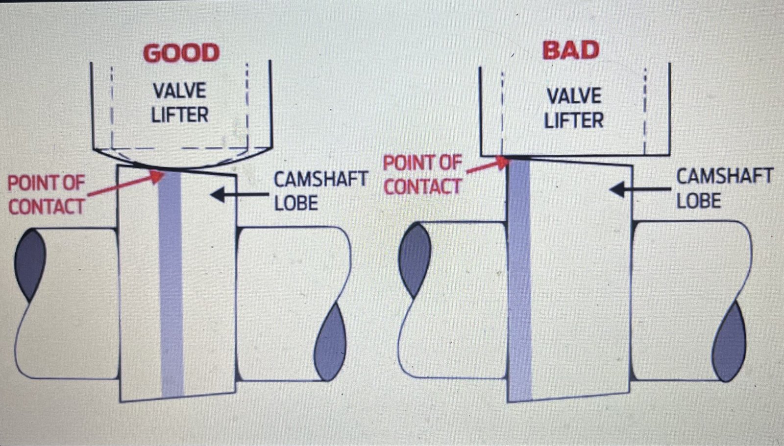

    below should give you an idea of whats good and whats not, this was pinched from a motortrend article. the point of contact is off centered to the lifter causing rotation. A dead flat lifter and a dead flat cam face will eat itself in minutes (in engines we own) the incorrect shape on either will eat itself quickly. Too soft material will eat itself no matter the shape , this last one you can check if you have a rockwell tester. The others can be measured and seen. There are a few things that have to align to not have a bad day, used to be most everything supplied was good to go, not now.

    There has been some testing done on flat tappet cam cores and lifters....results were that no soft cams were found, some soft lifters found, but a lot more were just poorly crowned or incorrect crown radius on the lifters along with some cams ground with no lobe taper at all....like they forgot to re-dress the wheel after grinding roller cams.
    (roller lobes are flat, ....flat tappet lobes are tapered to promote their rotation on the block).

    I only watched the last video all the way through because they're so long, but oddly the narrator never mentioned a crown on the lifter face, only a taper.
    This implies that he's grinding them with a taper vs. a crown.
