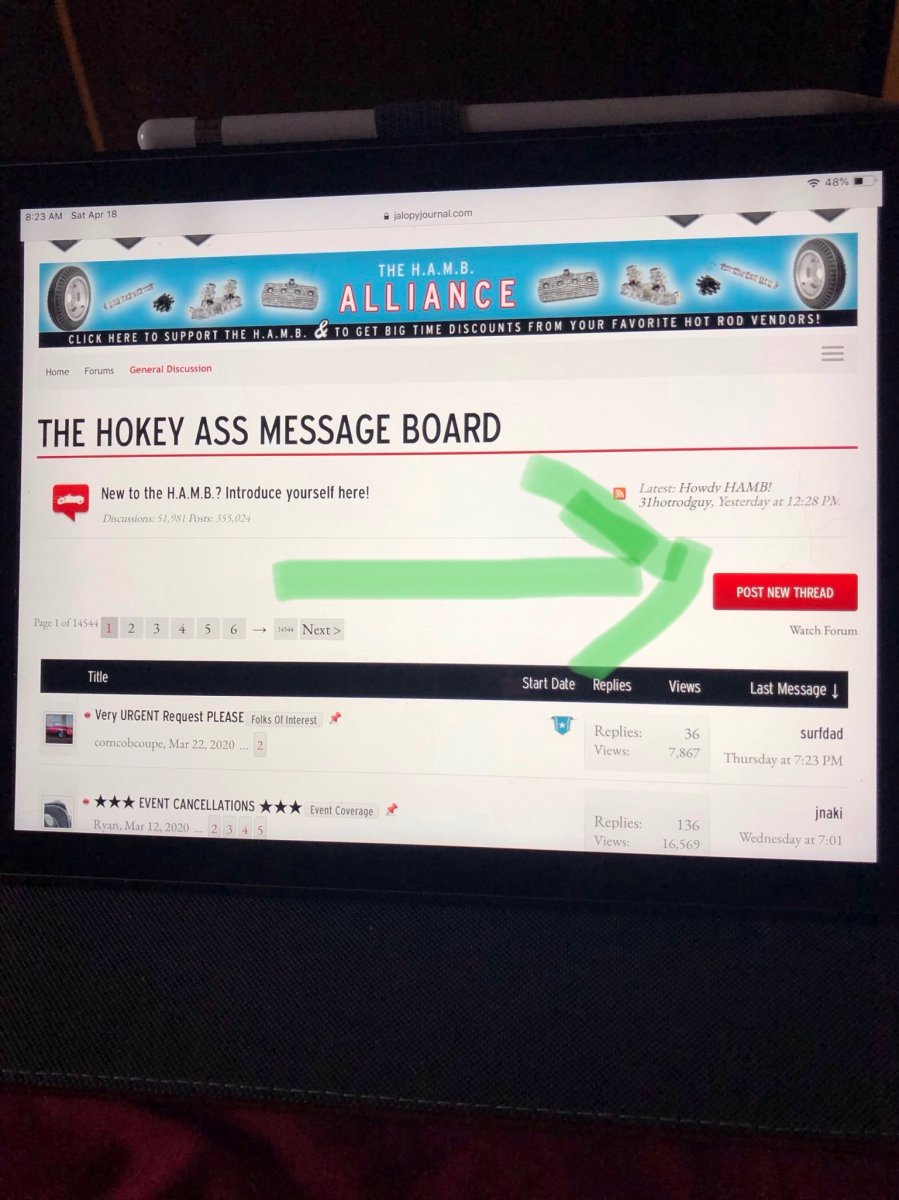

    1st: I'm brand new to this site and for some reason I can not seem to find where to start a post or thread or what ever you call it. Can someone help me with that?

  5. 88AFDCD5-6695-45CA-83DA-3C1E801D8EC5.jpeg It’s okay,,,we all start somewhere .
    It’s on the right side of the page at the beginning .
    Look for the red box,,,,I marked it with a green arrow .
    You can start a thread easy,,,,and there are a ton of 327 experts here .
    Good luck man .
    Tommy
