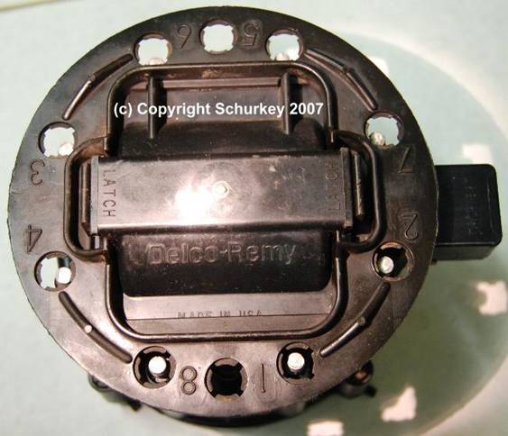

    I agree 100% moving plug wires is for those who can't get it right or are too lazy to do it right. dist1.jpg
    Find the timing mark on the damper and clean it off so you can see it good. a little white chalk or soapstone in the groove works good too. Clean the timing tab on the timing cover off so you can read the numbers.
    Pull # 1 plug and have someone bump the engine over with the starter until it blows air against your finger that you have plugging the plug hole. It make a good number of tries before you get it right or close enough.
    You can crank it over and watch the valves but you STILL HAVE TO line the timing marks up on the damper and the tab. No matter how many times you do it the marks have to be lined up.
    Once the marks are lined up drop the distributor in as shown below. with the rotor pointing to number one should be on the housing. To set Hei Correctly the rotor is slightly clockwise from where it is on a ponts distributor. I usually take a marker and mark the distributor housing where number one wire lines up on it to make it a tad easier.

    NOTE: PER fastcar1953, they have the cap reversed in this diagram below. The plugs for the ign wire and tach wire (that cube thing) should be directly opposite of what they show it as he shows in post 16. That is what I get for getting in a frigging hurry, dig up a diagram that has something wrong with it the hold down on the cap he shows actually shows the firing order on it. That is flat embarrassing.

    Pretty sure the hei cap is wrong. That would be 180 degrees out. image002.jpg

    You are correct. Time to delete that one and look for the correct one.
