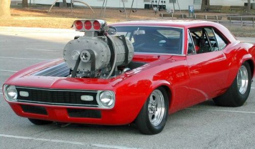

    Sorry - couldn't resist, but it seems like similar overkill to me. This blower was from a locomotive and story was it blew out the head gaskets and would barely turn over with the starter motor.
