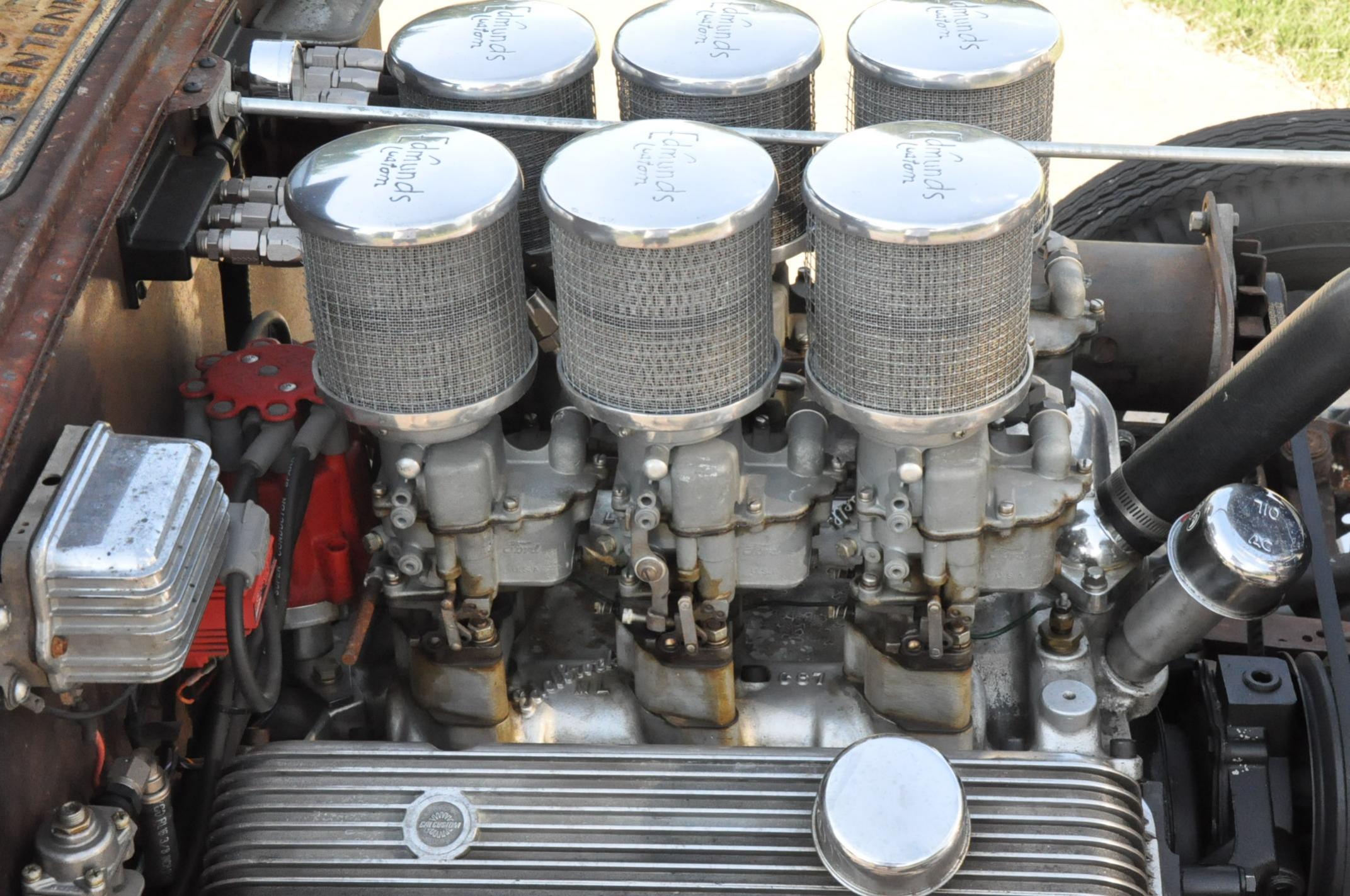

    Sure it can be done and runs WELL on all 6 :D. 383, Muncie and 3:23 gears and actually gets 13 mpg if you keep your foot out of it.
    run 3 Weber IDA 2 barrels on my Coupe and it , starts ,idles and runs better than ANY single carbed motor I hwith a 327 ave ever had.
