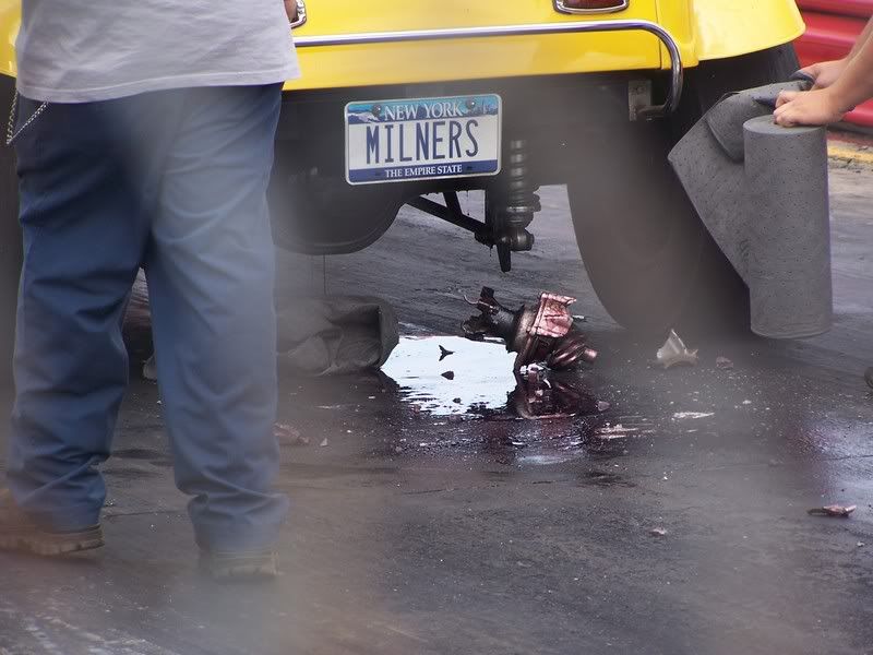

    and my opinion as well (been there)....in stock form with a stout motor they're junk
  19. swade41
    Joined: Apr 6, 2004
    Posts: 14,503
    swade41
    from Buffalo,NY

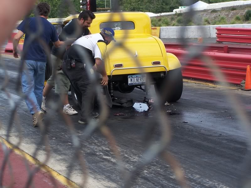

    I witnessed almost the same thing one day
