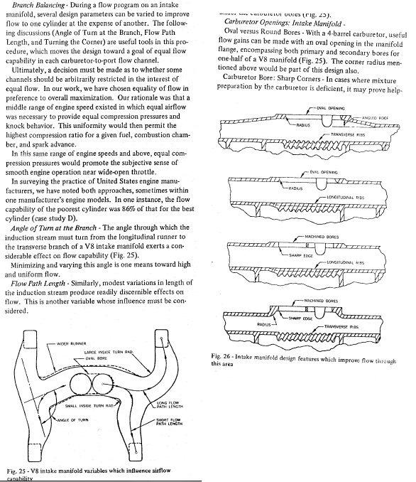

    That very interesting 1972 SAE paper 720214 about "Design. Refinement of
    Induction and Exhaust Systems Using Steady-State Flow Bench Techniques" talks a little about the difference in flow capabilities of one oval vs two round intake openings. Plus a bunch of other cool stuff.
    Based on that paper a reasonable guess is Chevy made the openings different in an effort to equalize the flow in the two planes, and achieve more uniform flow to all cylinders. They make the reasonable sounding claim that is a desirable goal allowing more optimum compression and ignition advance.
    By inspection the sharp corners and severely offset runners of that 340 HP don't include any of the high flow/equal flow details in 720214.

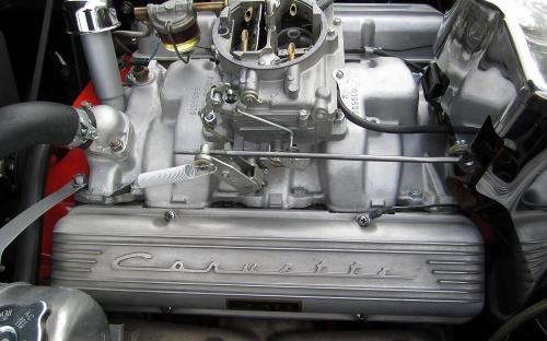

    1962 Honduras Maroon 327-340hp-8.jpg I owned a '62 340 hp Corvette, factory 327 with this manifold on it back in the 60s. It came with a single AFB. And that was no dud, for its day it was one good runner. It wasn't copied because the design was refined and improved, by my understanding. And since it was offered on Corvettes subsequently ('62-'65) I doubt it was a production line mistake.
