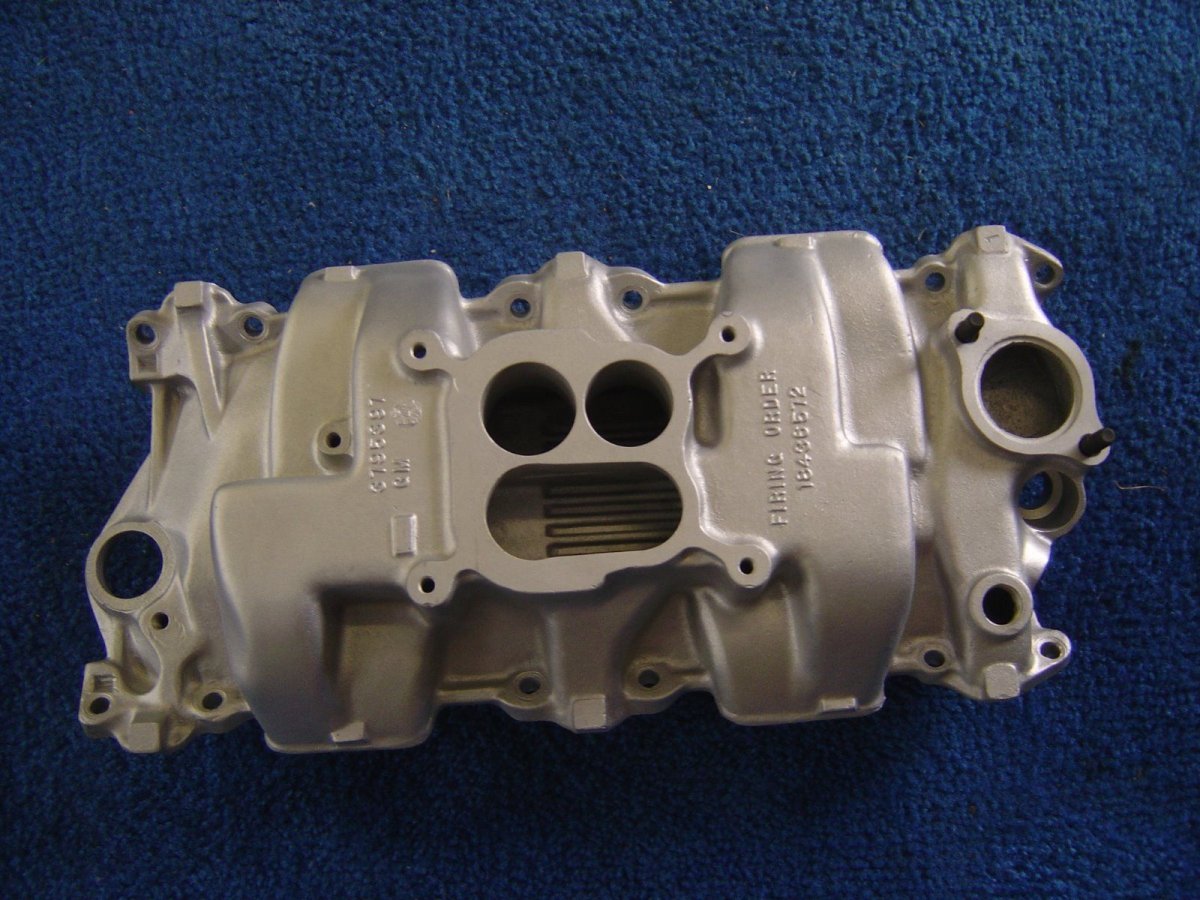

    '64/'65 intake, vacuum fitting in the back runner, oil fill tube angled to the left
    '62/'63 340hp intake, no vacuum fitting, oil fill tube angled to the left,
    And '66 intake, vacuum fitting, and oil tube angled to the right, to clear in the L-79 Chevy II, and the temp sender hole is in a different place.
    So yes, all three castings are different.

    Most obvious differences between the "461"(64-65) and the"490"(66-67) intakes is the orientation of both the oil fill and the thermostat housing.

    The L79 intake is a great intake. Chevy updated the intake in 67 for the Z/28 Camaro and that intake is almost a dead ringer for a C3B intake. I have 2 Z/28 style intakes on cars. I just scored this mint L79 for a smoking deal a week ago to put away for a rainy day.
    Z/28 Style (notice front tall runners) This is a 69/70 style as the 67/68 units has the thermostat housing close the L79 location, it was moved in 69:
    C3B Intake I have, these are closer to 67/68 Z/28 units:
    L79 Intake I just scored:
    1Nimrod likes this.

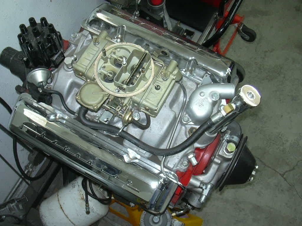

    Where did this engine (L79) **** in its air for the PCV system? The rocker covers were sealed and so was the oil fill tube.
    1Nimrod likes this.

    If you look close, under the vacuum advance, you can see the breather tube that goes from the back of the block to the air cleaner base. The PCV valve is in the oil fill tube.
    1Nimrod and jimmy six like this.

    Thanks. I guess they still had the can in the valley and the the feed you showed me went to the underside of the air cleaner.
    1Nimrod likes this.
