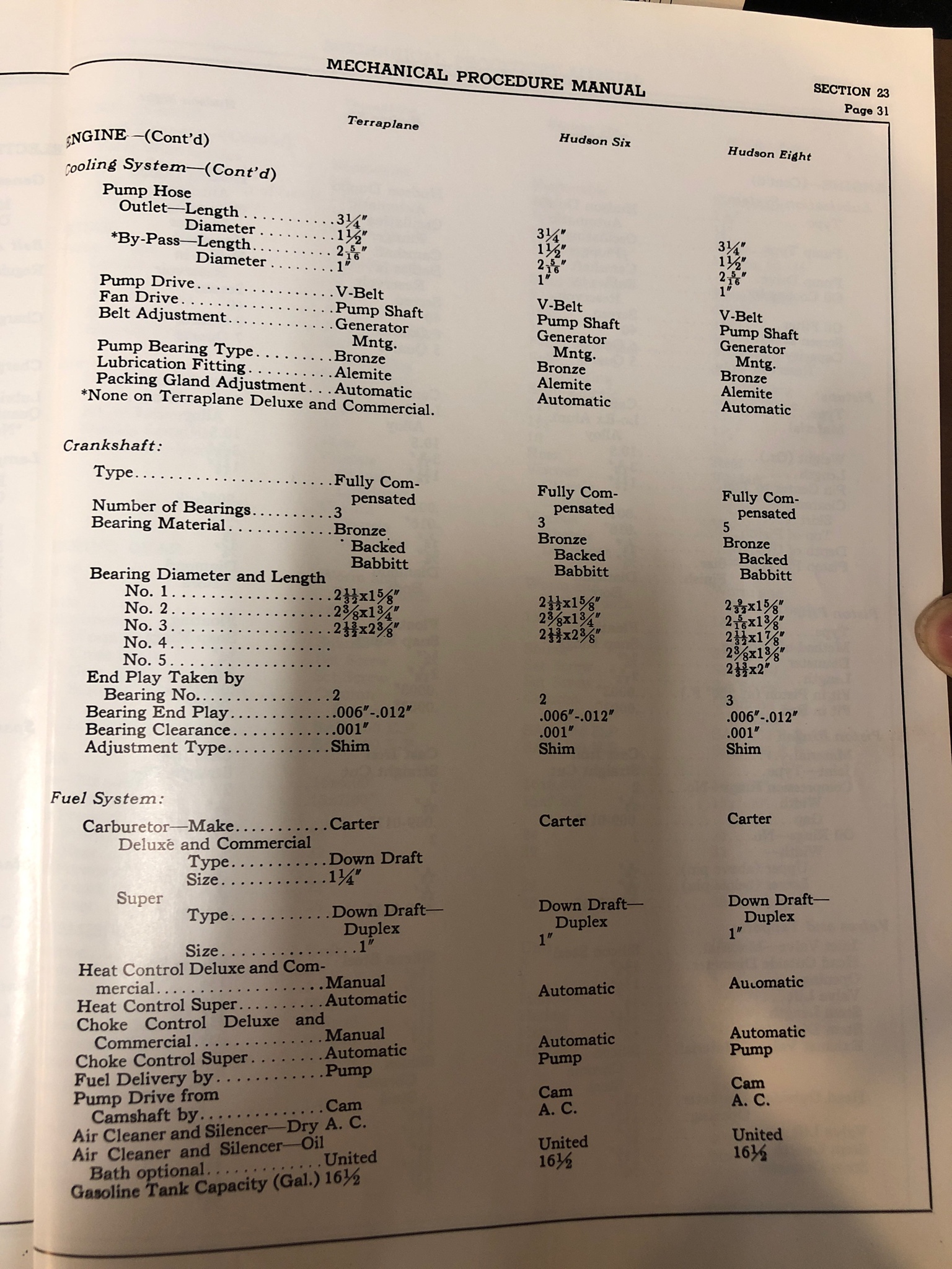

    What do you guys think of how I could adapt / position a supercharger on the engine? As you can see the exhaust manifold comes up & to the front before going into the exhaust pipe. The intake is entering the engine below the exhaust & on the side of the engine.
    Currently the compression for the Standard Head is a lowly 6.25 & this vehicle is the “Hudson Six”.
