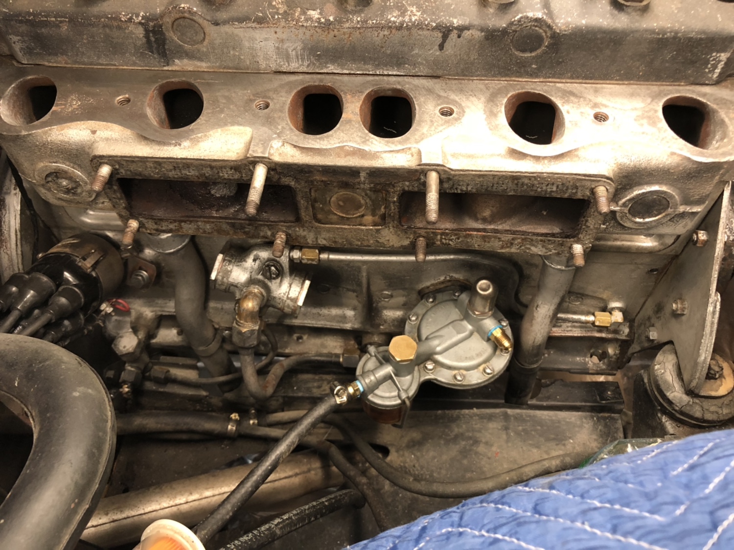

    Here are a couple photos of the intake & exhaust. The exhaust manifold & intake manifold are separate however they do bolt together at one point to provide hot exhaust air to warm the intake.
    One can see the two bolts which hold the two manifolds together. Hopefully this makes sense.

    I spoke too quick about adding the 4-71 to your engine because I NOW see too many difficulties with the exhaust ports being ABOVE the intake. Also problematic is any in-line 6 would require (what I
    consider) too LONG of a blower drive extension. In the pictures submitted of the 5850CC Hudson
    engine,..... notice how long the blower drive snout is...and on a 4-71 or 6-71 there are offered
    numerous "used" inexpensive drive snouts at a low price in numerous-various lengths...but none probably long enough for inline application. Putting a 4-71 on my flathead was CHEAP and easy.
    Putting one on your engine would be neither.
    The Rich Fox post about maybe going with a used Eaton (or similar) is probably your best option.
