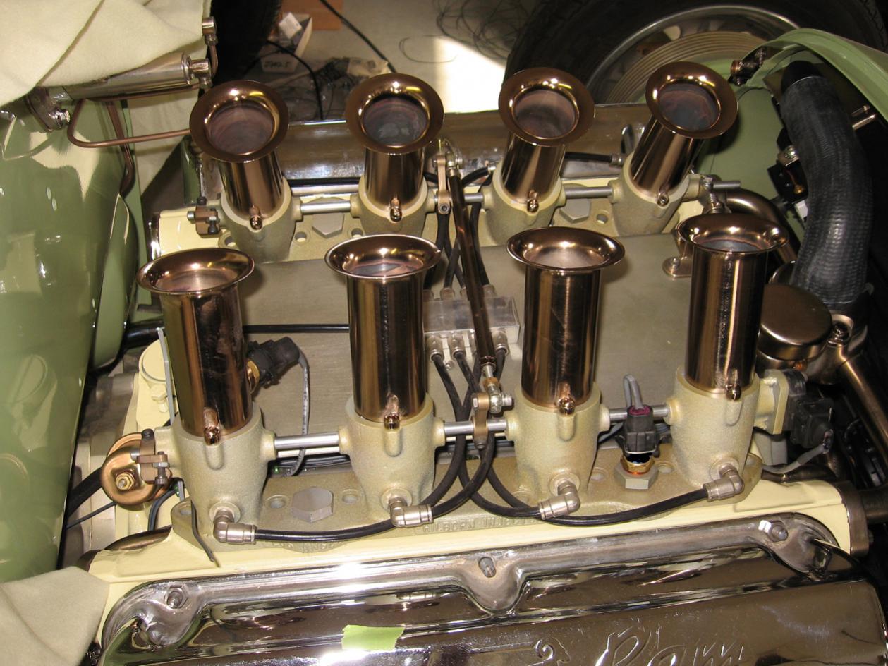

  5. This system looks good.
  6. Oh, you are NOT serious!!?? HAHAhahalolololmaorofl

    Gee, this system looks good too. Not sure what that has to do with whether or not its traditional...
    Considering that this IS the HAMB, I had better point out the obvious. Its not.
