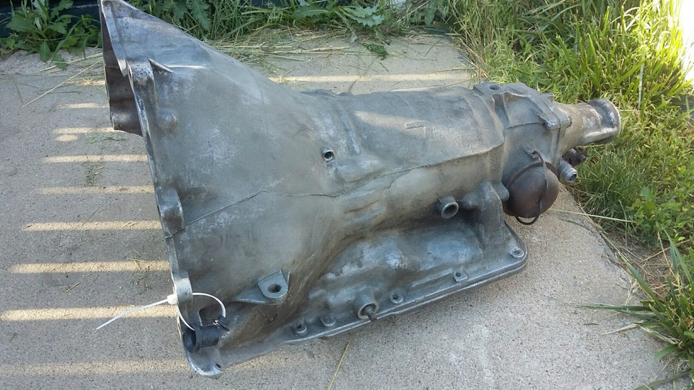

  7. A quick peak under the car should tell you real quick
