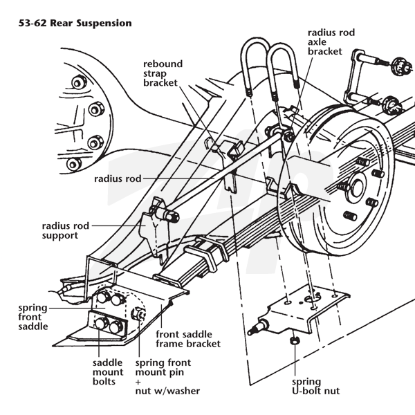

    My corvette has something called radius bars. they look a lot like cal tracs that mount above the rear axle. Mine has 2 inch lowering blocks and these bars keep my rear springs from wrapping up (I drive that poor car like I don't have a nickel in it) maybe something like this would work for you

    Another example drawing of 'radius bars' from early seventies Australian performance falcons (GT, GTHO and Landau hardtops). This would be easy to add, virtually invisible, and do the job with regards to spring wrap......:)
