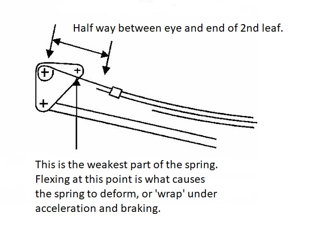

    The caltrac bars work because, as the axle tries to rotate, they apply downward force to the top of the spring at it's weak point, thus working against deformation and 'wrapping'.
    ******* bars work against spring wrap by contacting under the frame rail or spring eye to physically limit the rotation of the axle.
    If ******* bars (either normal underslung or @Crazy Steve 's top mounted version) are going to make contact and exert upwards pressure at,or near the weak point of the spring itself, they will actually be trying to add wrap. Leaf spring weak point.jpg

  5. You're fixated on the springs, and you've given the answer as to why ******* bars work... to physically limit the rotation of the axle. That's it, end of story. Look at it this way: you're concerned that the spring will deflect with just a simple 'loop' under it. But if the snubber was contacting the front eye, what's preventing the spring from deflecting now? There's virtually no support for it, yet the bar works... because you've physically limited the rotation of the axle. Moving the contact back a inch or two (and spreading the contact over a wider area, putting that 'weak area' in the middle) will do the same thing. Some tuning will likely be needed, but that should be easy.

    You are not considering the length of the spring. One inch from the front support bolt, the spring is extremely stout! Think bending a one inch piece of wire vs bending a 18 inch piece of wire! Leverage! Or the lack of! Length in leaf springs is very important!
    The closer the better to the bolt, but it is not necessary to be directly under the bolt! But you can’t be five inches from it either.
    Bones

    I’ve ran ******* bars that hit the spring behind the eye on lower horsepower cars with no problems. Unless you have high horsepower and are trying to get everything you can out of the ch***is it shouldn’t really matter that much. Only difference in Steve’s design is the bar is on top pulling the contact up instead of being on the bottom and pushing it up. It will still stiffen the spring either way.

    As I have said in a previous post, it will work to some degree with the bar contact point under the actual spring. If that is 'near enough/good enough' for the OP, then he should go for it. His mind seems set on his design, and I hope it does what is needed in his situation. That one time he launches hard could tell, but that is never going to happen, is it ????
    A couple of slight changes, that should not be very hard to accommodate, would have it working to the full capacity capable from a ******* bar system (basic yet effective). The original question seems to have been asked to gain confirmation, not actual advice. So here is my answer at this point. Yes, it will work, but not as well as it has the potential to work with a few easy tweaks...........
    We just need to agree to disagree. I like to see things work to their full potential. Hey, it's just the way I am. "Job worth doing" and all that.................;)
