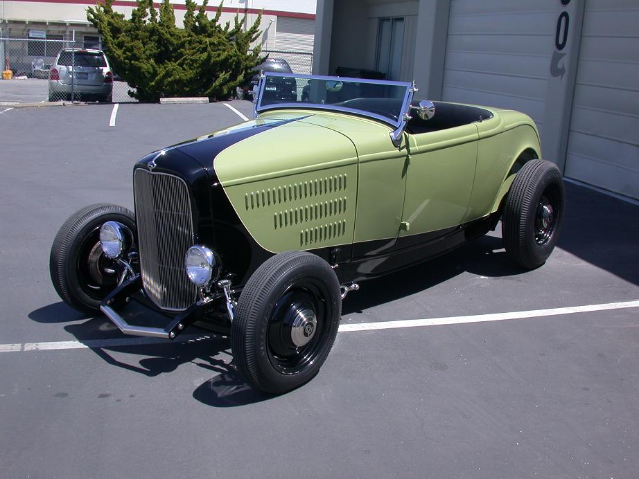

  9. HotRodderDaughter
    Joined: Oct 21, 2011
    Posts: 108
    HotRodderDaughter
    from San Diego
    Thank you for all the suggestions! Yes my glasses are HUGE and I love them! And yes my dad IS Sid Chavers, you'll see he commented on my first post, but since he does not have any friends/clients etc. in San Diego, he suggested I'd take to the HAMB for suggestions for a shop. Yes googling works, but who's to say who's good & who's not. I appreciate all the help! I'll keep updated as to what happens. Thanks again. :)

  12. Atwater Mike
    Joined: May 31, 2002
    Posts: 11,618
    Atwater Mike
    Lindsay's roadster is as classic today as Veda Orr's was in 1940. That Bop Top looks like it grew there...
    A truly beautiful roadster. Radials look practical.

  20. HotRodderDaughter
    Posts: 108
    HotRodderDaughter
    from San Diego
    It died while driving. Went to give it gas and there was nothing there. It's only happened two times (on the way home on my last drive in it) and after putting the car in park and restarting it, it starts RIGHT back up and works fine. Hope this explaination helps!
