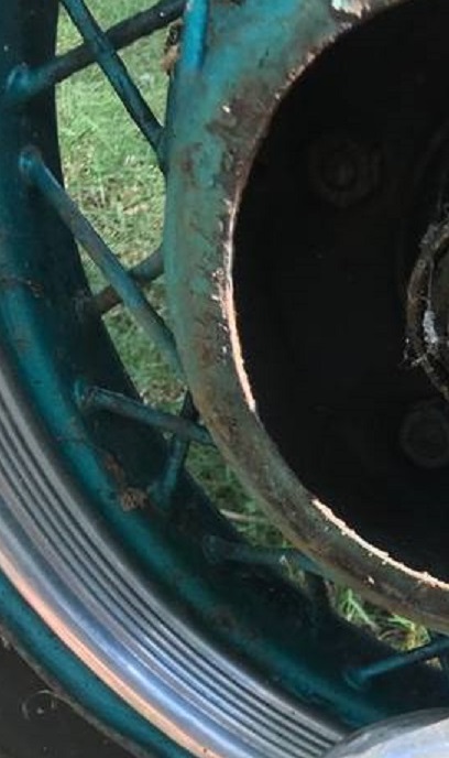

  9. My almost non-existant computer skills are getting beter.
    Enlarged photo shows what look like genuine Ford spokes / welds on those 16 inch wheels.

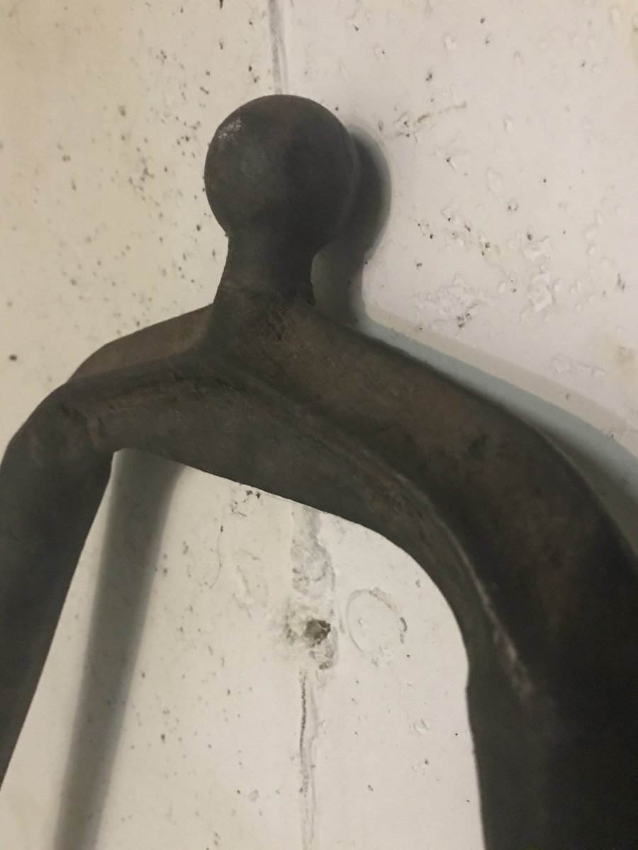

  10. Fordors
    Joined: Sep 22, 2016
    Posts: 6,599
    Fordors
    The ball end forging has a completely different look, shown is a ‘32 wishbone end and the ‘33-‘34 is similar.
