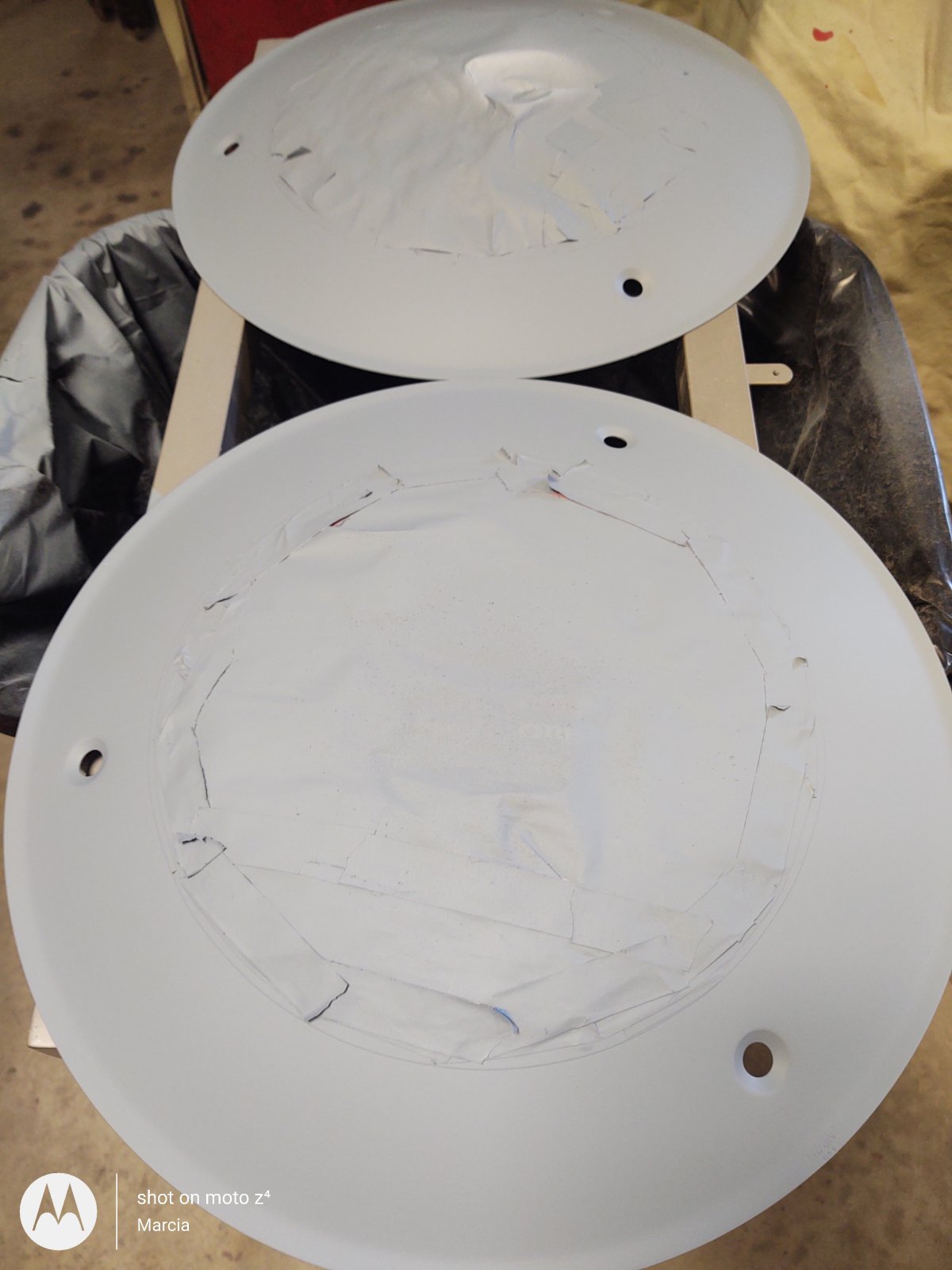

    I used Nason hi fill primer. I wanted to fill in the groves in my moon discs for a special look. I just put paint on them

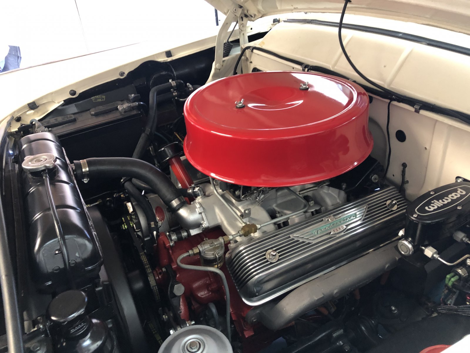

    I’ve used Rustoleum and Duplicolor sandable and thought both were good. I like Duplicolor best because I can get 3 colors. The 1956 Purolator dual quad air cleaner looked like an acne face when I bought it and is perfect now done only with rattle can spray primer, color, and $25 a can high solids clear coat from an auto paint supplier. BB5E0B72-BE79-41B1-8C84-0C613644A6E2.jpeg

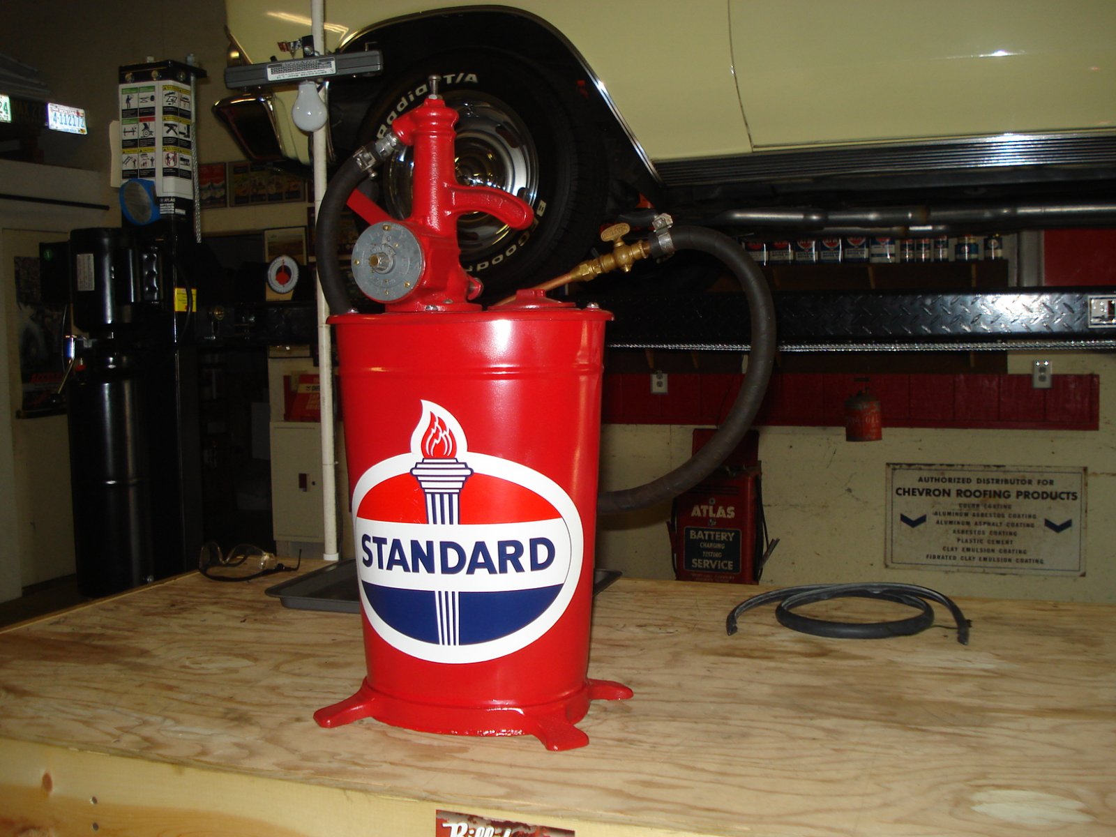

    Bondo 720 primer
    Duplicolor auto spray paint
    Rustolium Clear acrylic lacquer

    Thanks took 2 years to find one. 1956 NASCAR approved one year only. . Dual quad models for every manufacturer. Each slightly different. This one is for the Ford.

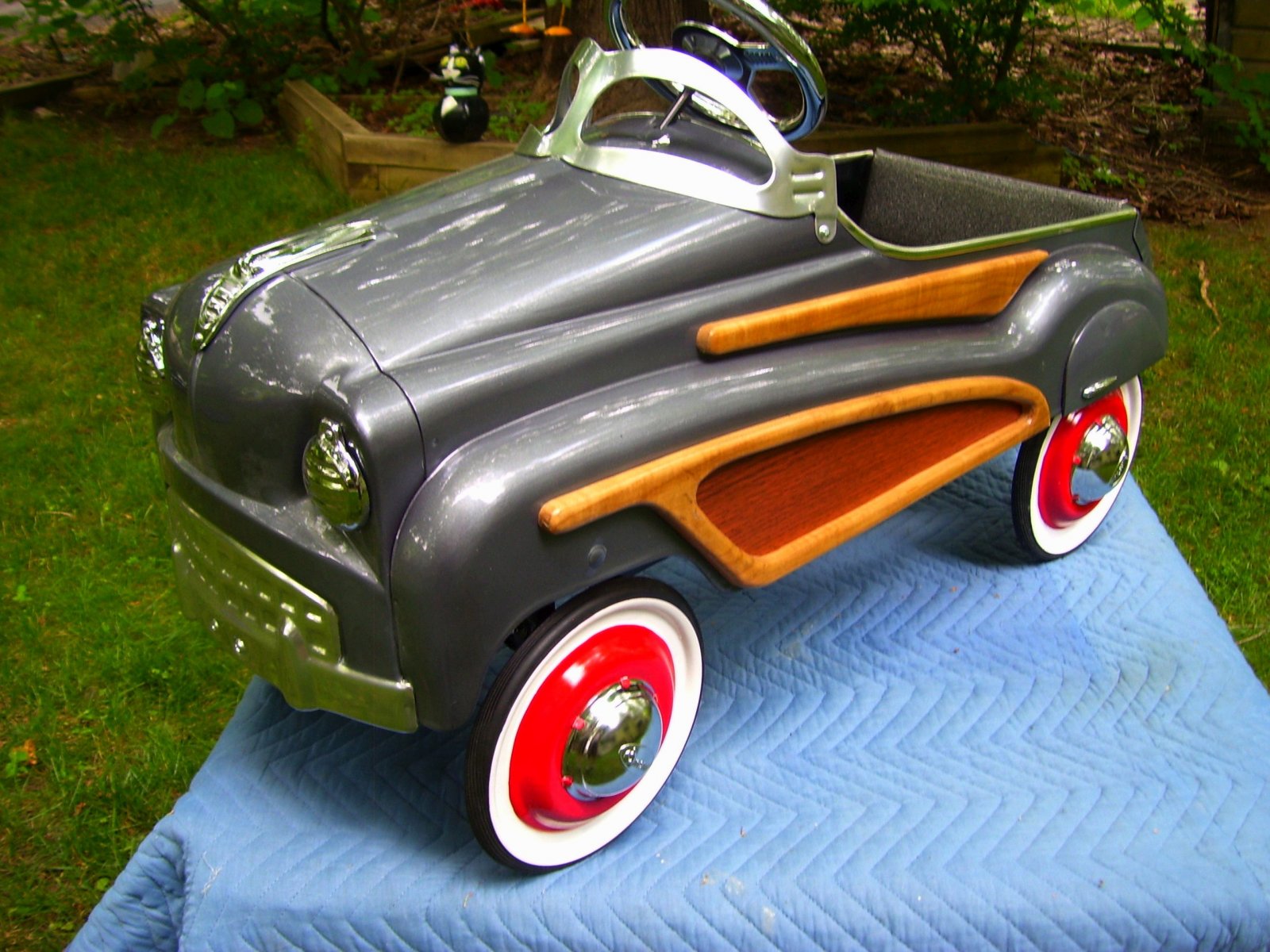

    Sandblasted, primed with Krylon and painted with Krylon. I have been using it since a teenager (and that is a lot of since) and love it. DSC07003.JPG DSC07895.JPG DSC07399.JPG
