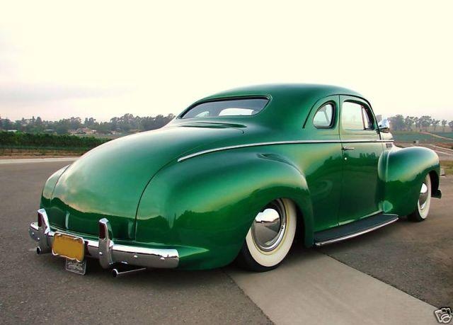

    The wheel covers in this photo are NOT the cheap, readily available "smoothie" hubcaps available practically everywhere. I have a set of those and they are nowhere near as DEEP as the ones on this car. Look how round the center is and how far it projects out from the sunk portion of the cap.
    I have never seen a set like this but would love to find a pair. Can anyone steer me in the right direction? If they are old/original, what brand and era? If they are new, who makes them like this?

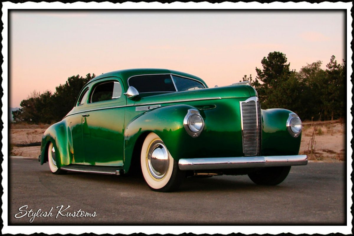

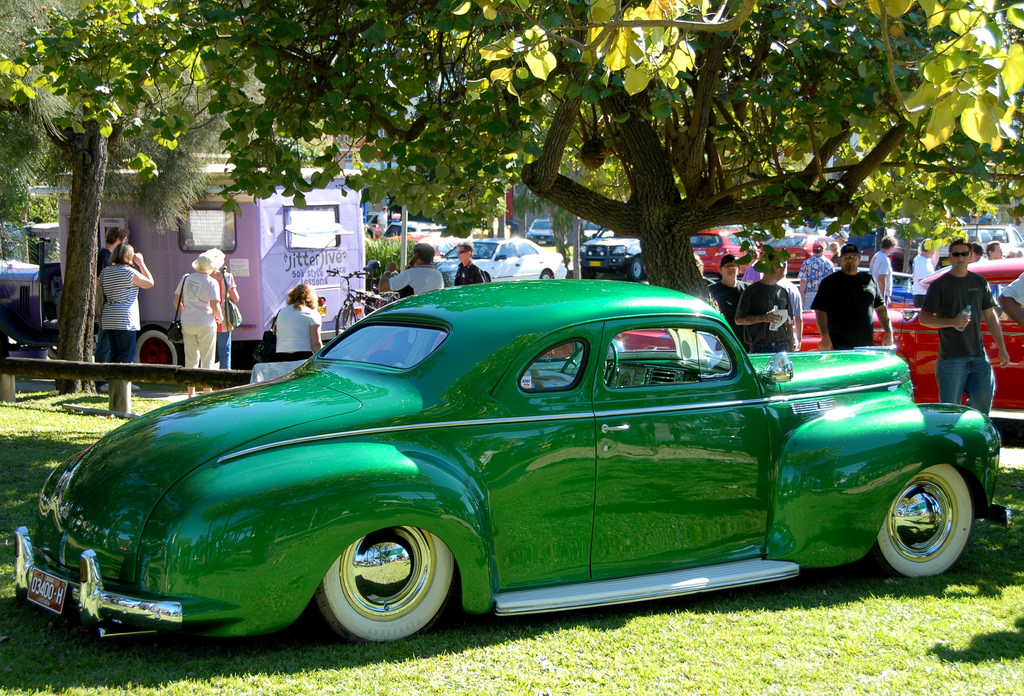

  7. I don't think they are full caps. I think they are center caps over the chrome rings (could be OE, may be "chromesides") that simulate full caps. I found these photos (pretty sure this is the same car that you posted, the blue might be photoshopped). Look closely at the caps and you can see the line between the cap and the ring.

    OH!! Yeah, I noticed that faint line in the photo I posted but I didn't realize it was a seam between a cap and a ring.
    I believe you are correct, Sancho. Thanks!
    I am already casually hunting for a set of those filler rings anyway.
    Pretty sure I saw and photographed that car in person years ago at Paso Robles, but at the time I was not as obsessed with wheel covers as I am now so I didn't look at them closely at the time. And I didn't realize it was the same car until you pointed it out. The photoshop color change fooled me, but it's obvious to me now.
