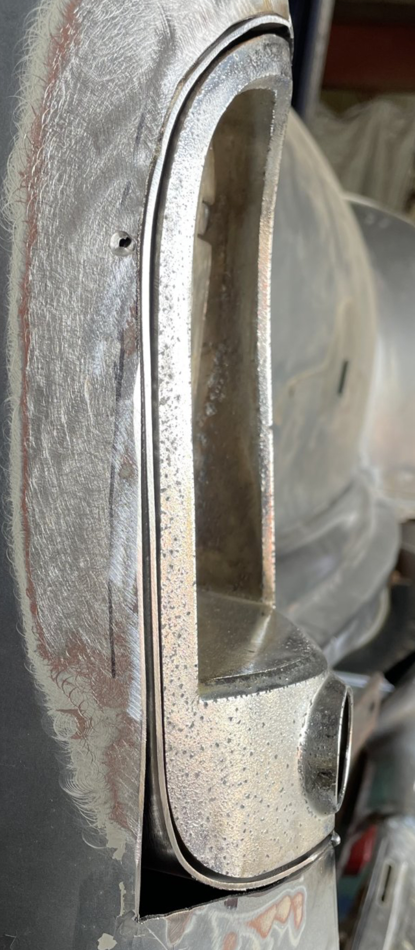

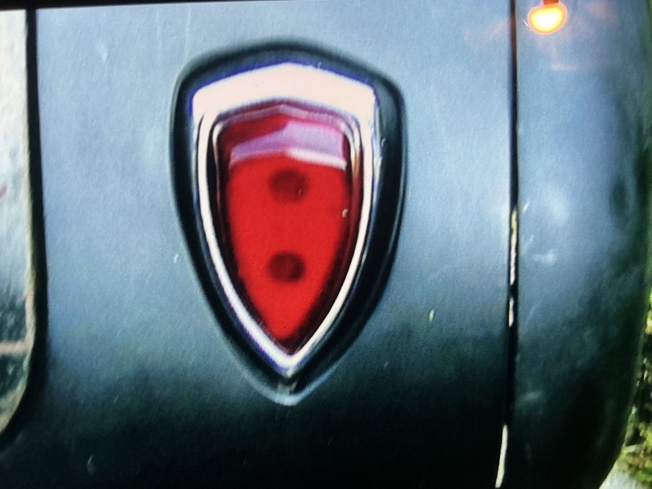

    I think this really looks good , and would like to mount my tail lights the same way, but I'm not sure if this was done with a die or hand formed or what. Anyone know a good way to do this?
  2. RodStRace
    Joined: Dec 7, 2007
    Posts: 8,962
    RodStRace
    I'd guess it was custom, either hand formed or as you say, a pair of dies. If a company made a flat panel with a flare for a '39 teardrop, it wouldn't work on a curved panel like this, requiring hand forming anyway.
    If you wanted to replicate this yourself, a die that's curved and shaped to make the flare could be fabb'ed out of wood if that's easier for your skills, but I'd expect even if you got 2 panels ready to weld in with the proper curve and flush to the housings, there would be metal finishing involved after they were installed.
    It's one of those little signatures of a well crafted hot rod that whispers, "I've got the eye and the skills".
    EDIT: I'll mention that it is sticking out at the top, and inset at the bottom. They went for an exact angle of the light, then split the difference top and bottom. Not all inset, not all bulging out. Master work.

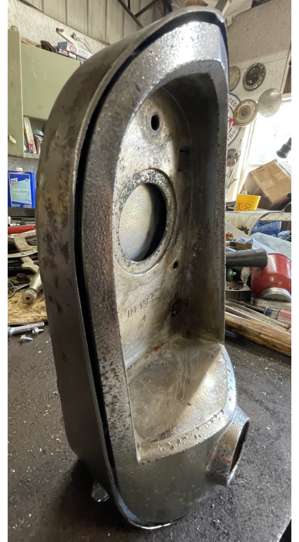

    I hate to use the S word but Speedway and no doubt several others sell the recessed buckets for a 39 tail light to make it easy to french it in and then make your own lip like in the photo. Screenshot (1899).png

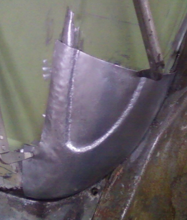

    I would think it is to better to hammer form a bucket, then weld it to the panel. Trying to hammer form a bucket in to the panel will not leave enough room for the hammer. I made these buckets that way and rolled a flange to **** weld to the panel IMG_0639.jpeg

    Due to the somewhat difficult shape, I think these might work as a good starting point.
    I think they could be embedded in the panel and then trimmed and maybe a small rod attached to the protruding part for some roundness and dressed to a decent shape. I can try it on some slightly rolled s**** sheetmetal and see if it works out like I'm thinking. :)

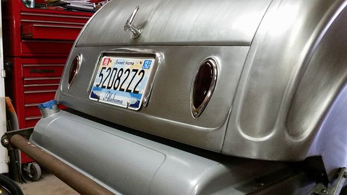

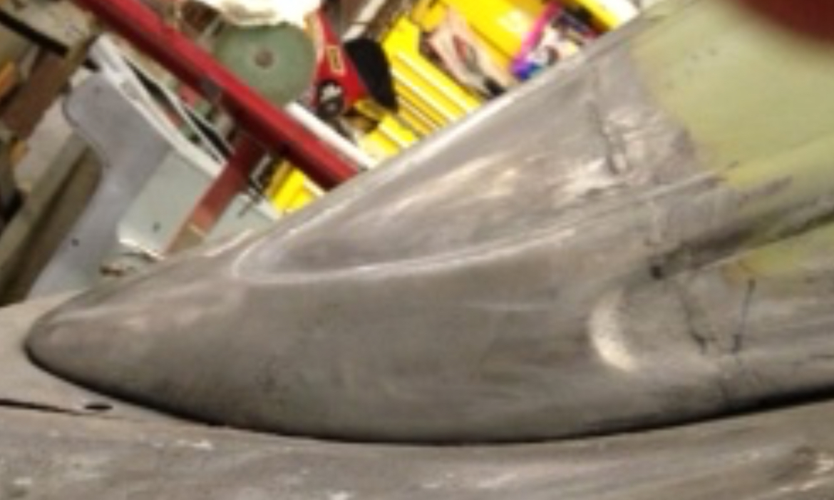

  18. A bucket isn’t very hard to make
    We built these for modified 51 merc lights
    it does help when building to fit crusty pieces though.
    Almost hammerd a detail like you’re asking about on the top. Decided to leave it smooth

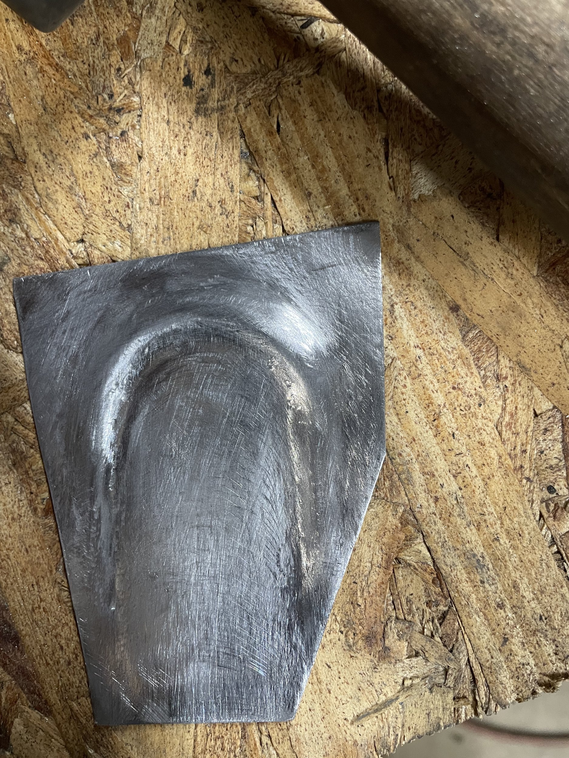

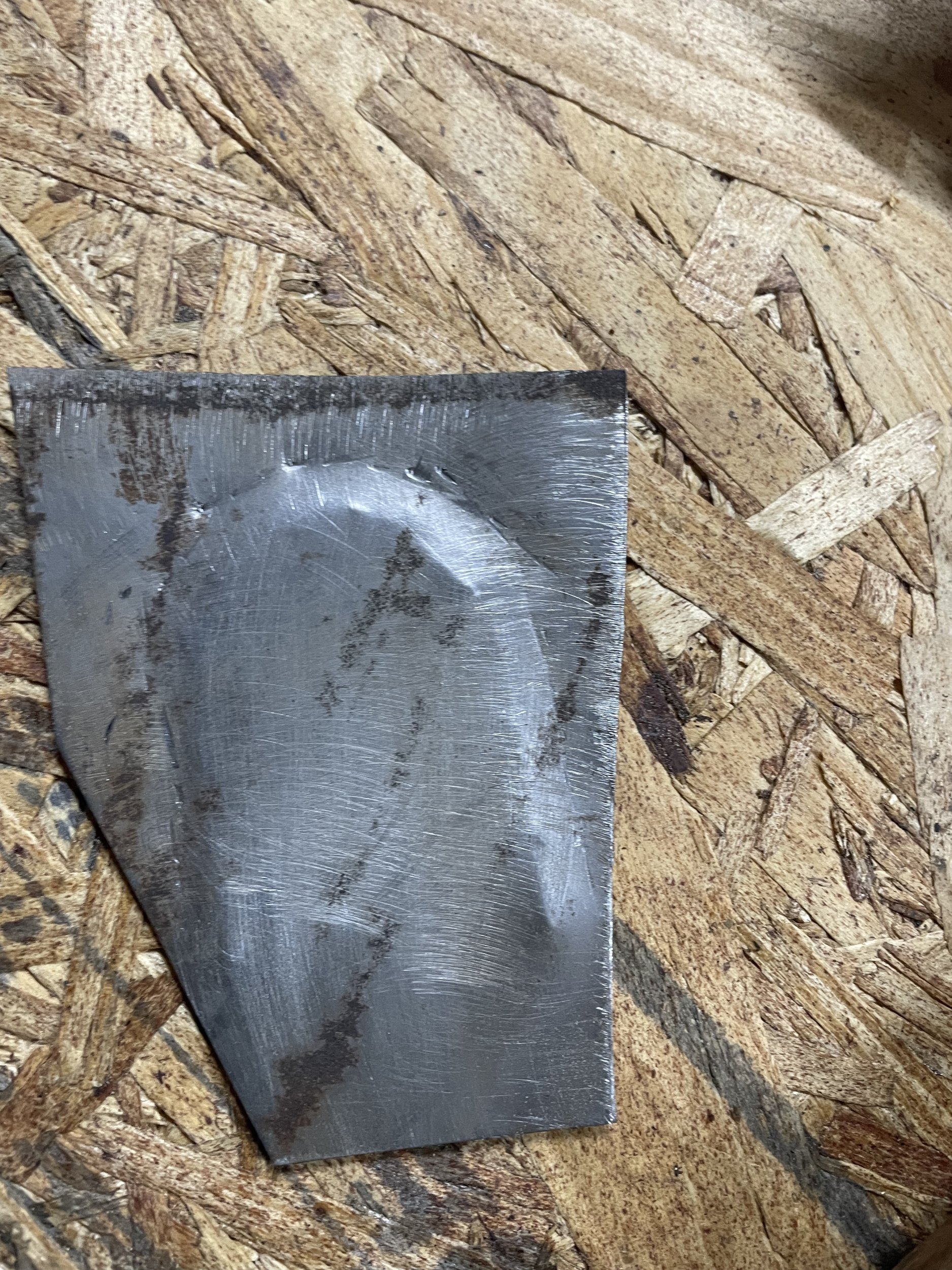

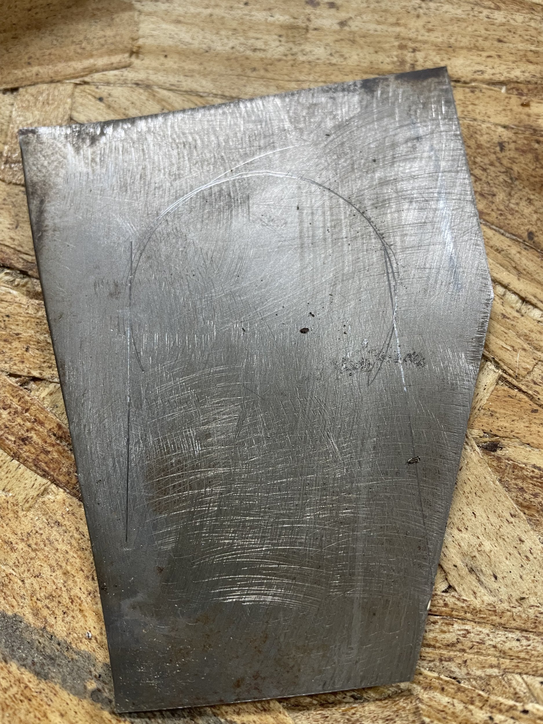

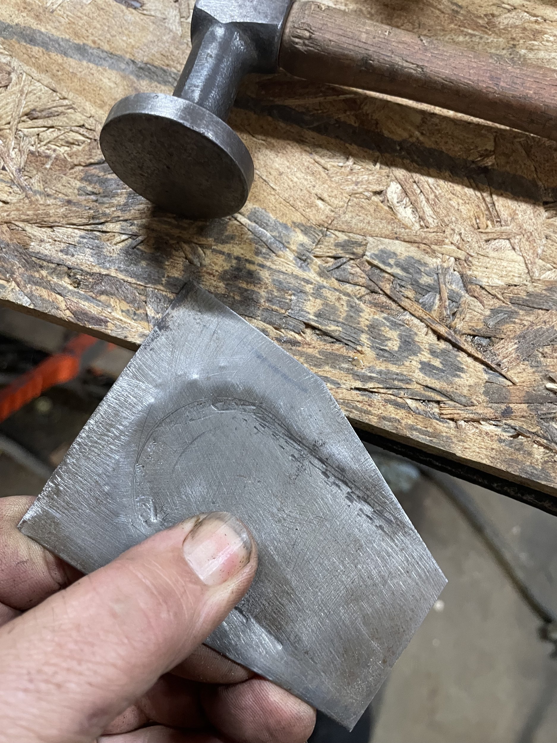

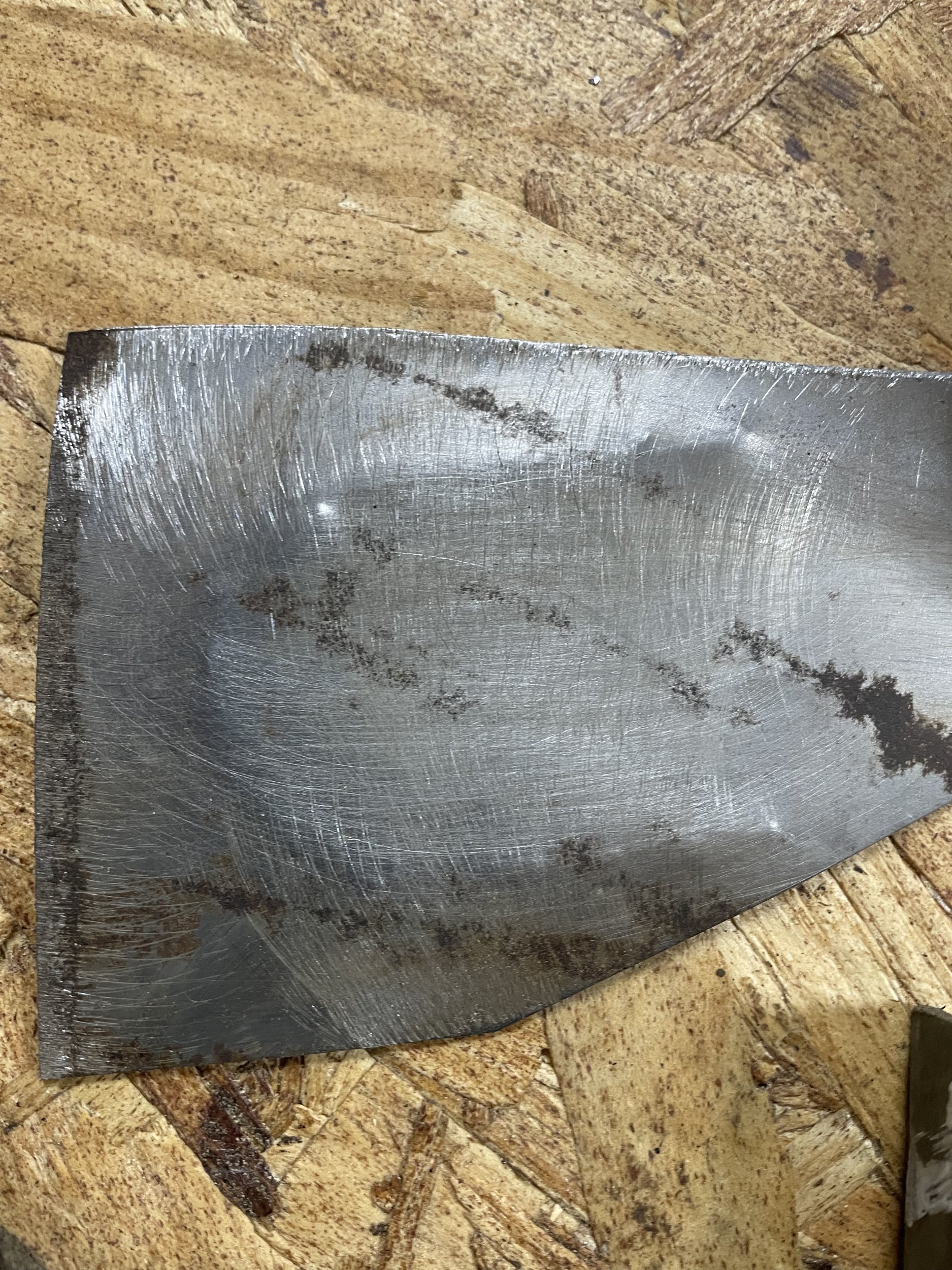

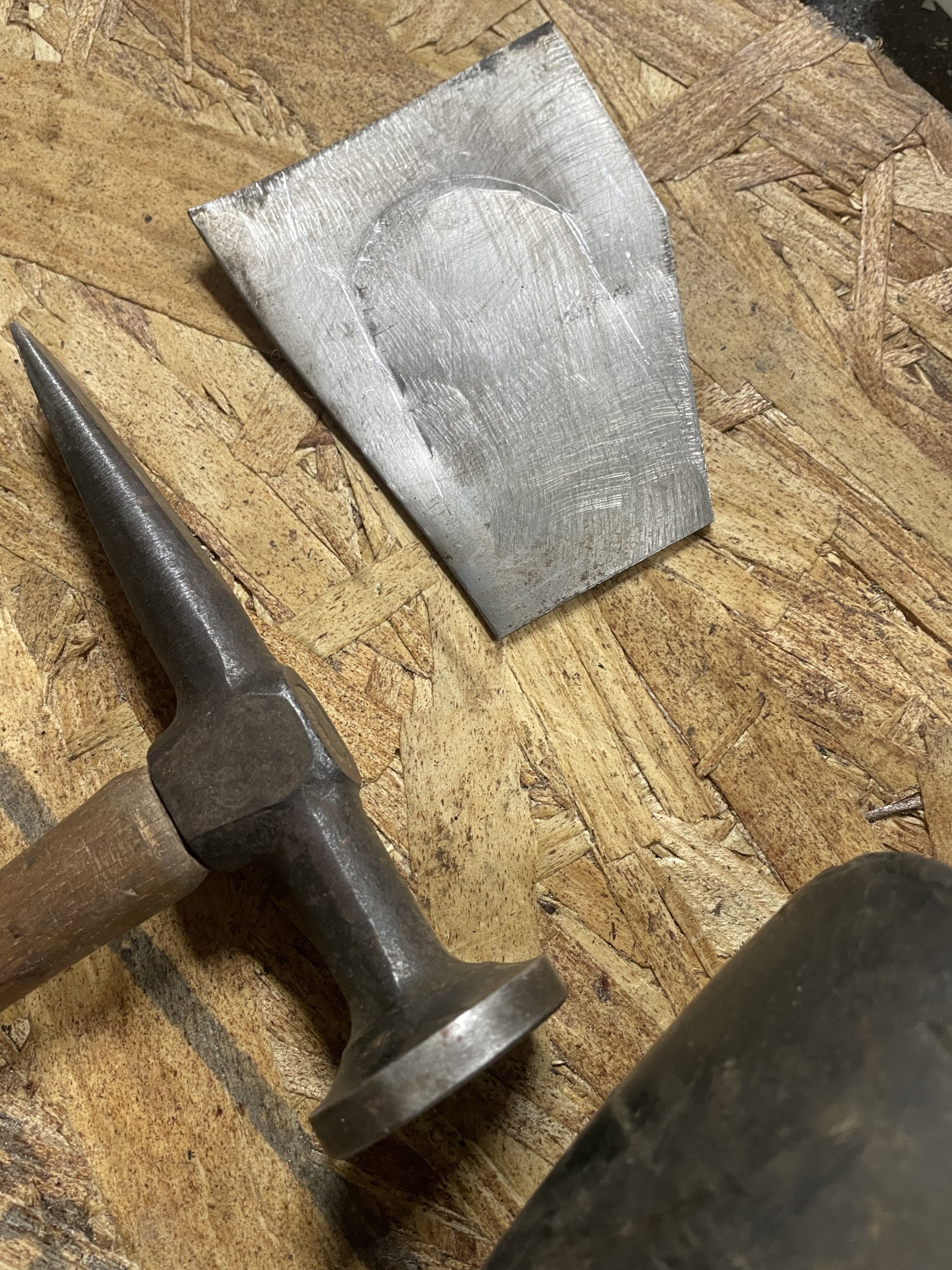

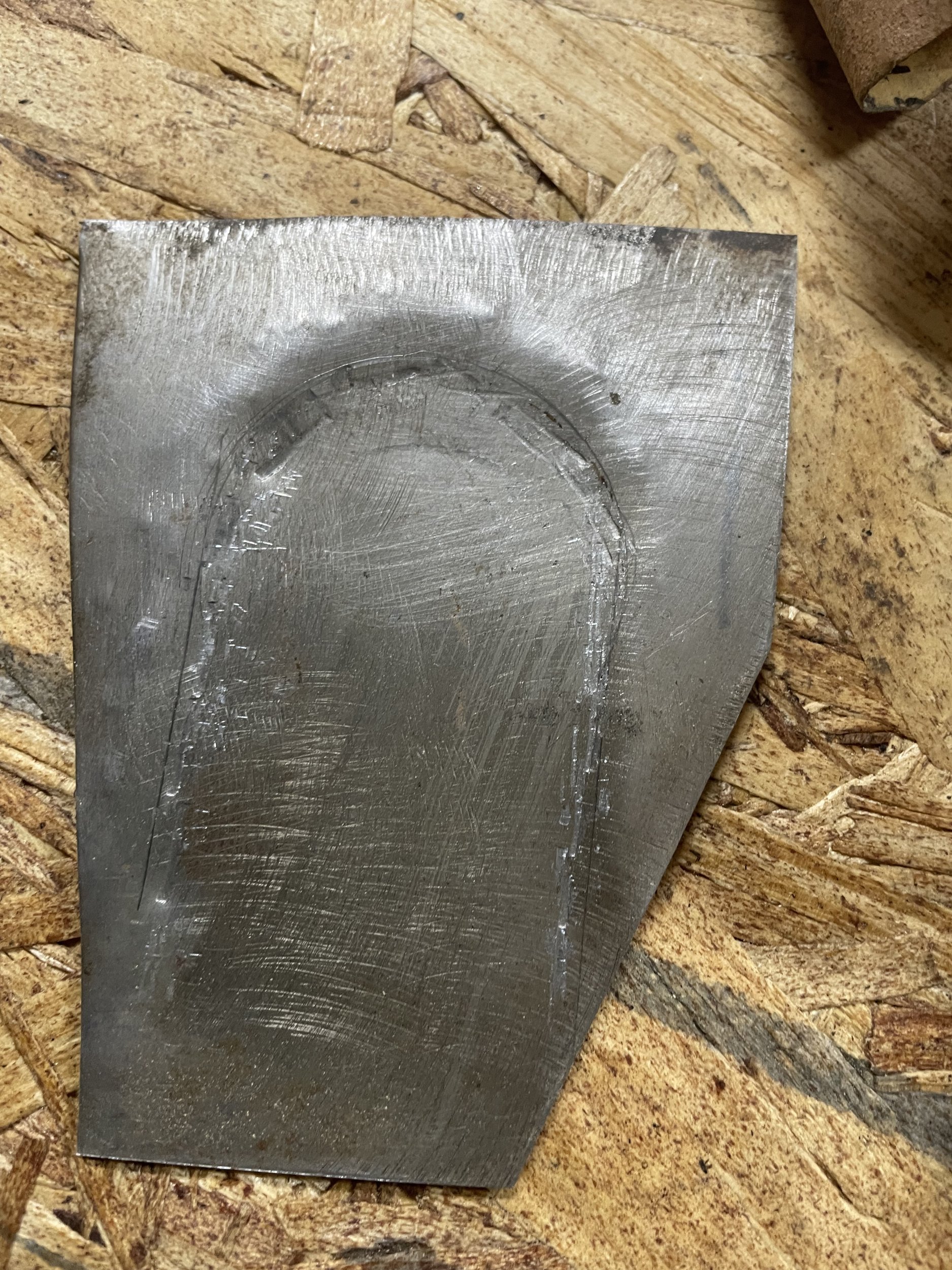

  19. With a stamping machine or Pullmax you can machine/grind and file male and female dies to a desired profile.
    The taper part is learning how and when to back off the machine.
    Or whack it with a hammer.
    Here’s a crude tutorial how.
    Figure out a shape (piece of s**** 18 gauge from the floor)
    Then start whacking. I use the chisel end of a body hammer and hit the other end with a rubber mallet
    then flip over and continue whacking
    flip back and forth until ya get the shape ya want
    The edge of a bench comes in handy(wood on steel bench)
    keep flipping and whacking
    then clean it up.
    Quick crude tutorial
    You can keep hammering and sharpening up detail and better finish work if desired.
    This one tapers towards the curve. You’d be surprised how deep you can stretch this stuff

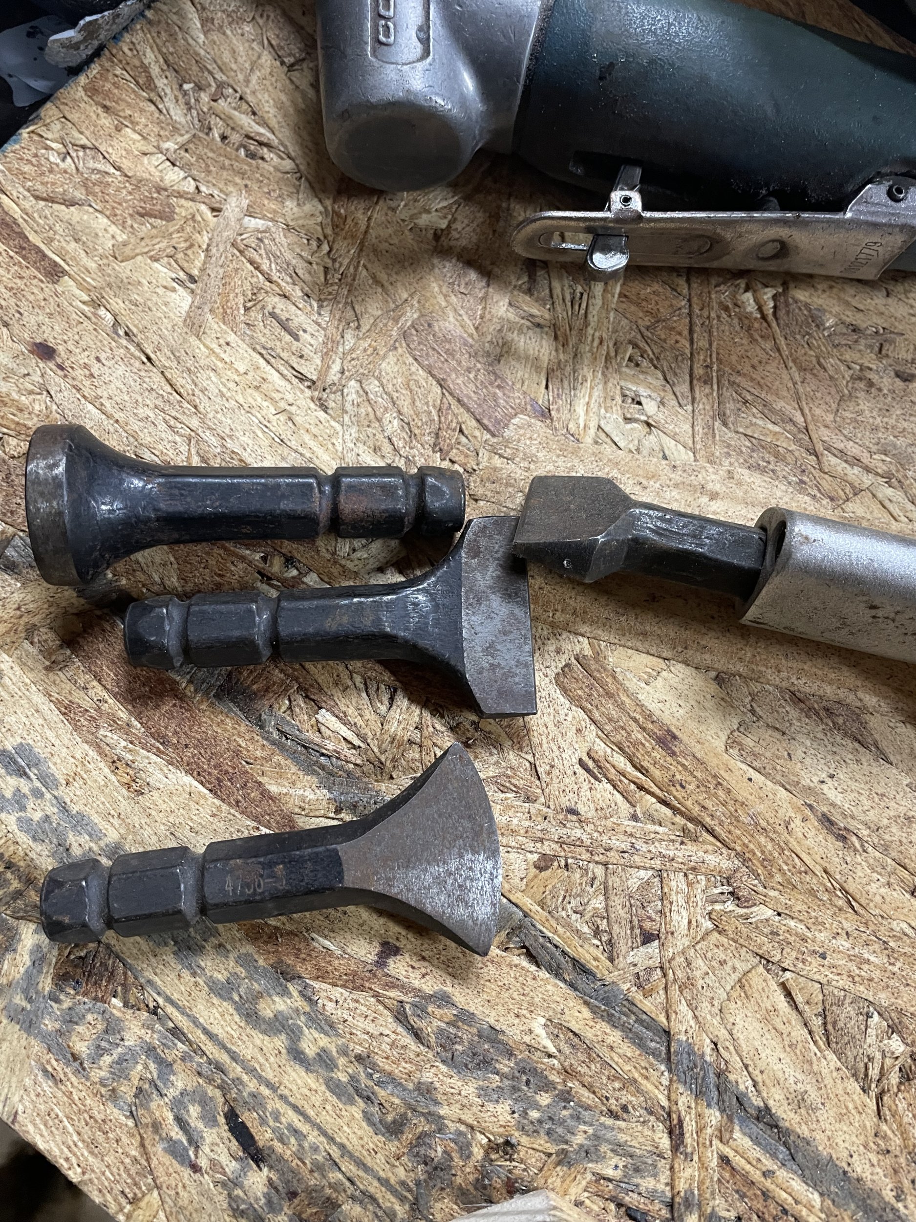

    Tools used: chisel hammer, rubber mallet, pieces of wood, sturdy bench.
    This shaping chisel set helps

    Good stuff. love to see metal shaping on the hamb. Good idea to go this route as those flat tail lights never sit that great on the curved below deck panel.
