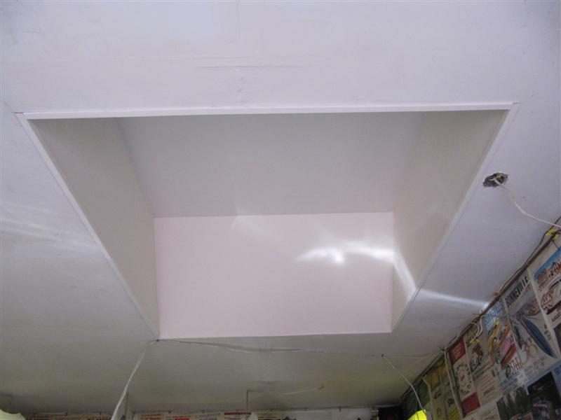

  16. This was my solution.
    I was lucky that the roof joists went the right way.
    I reinforced the joists and stringers and framed the box, and used 1/8" plywood to cover it.

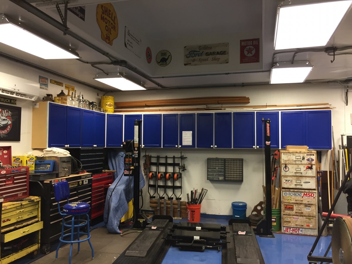

    [​IMG][​IMG]
    If you have low ceilings like I do. Consider getting yourself a Maxjax portable 4’ hoist and a couple sets of anchor bolts.
    I can use it as a straight pull in lift. Or have it set up fore and aft so you have full access to the side.
    FANTASTIC for block sanding without killing your back!

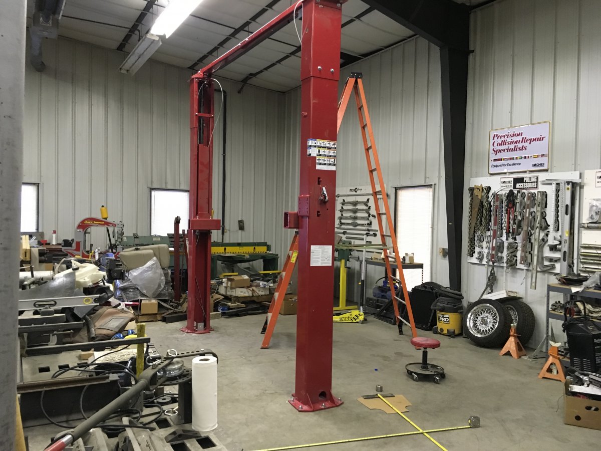

  28. I’ve seen a few setups where just the columns go thru and above the ceiling, then to top cross bar is installed in the attic above the framing.
    Also seen garage trusses reframed and ceilings raised.
