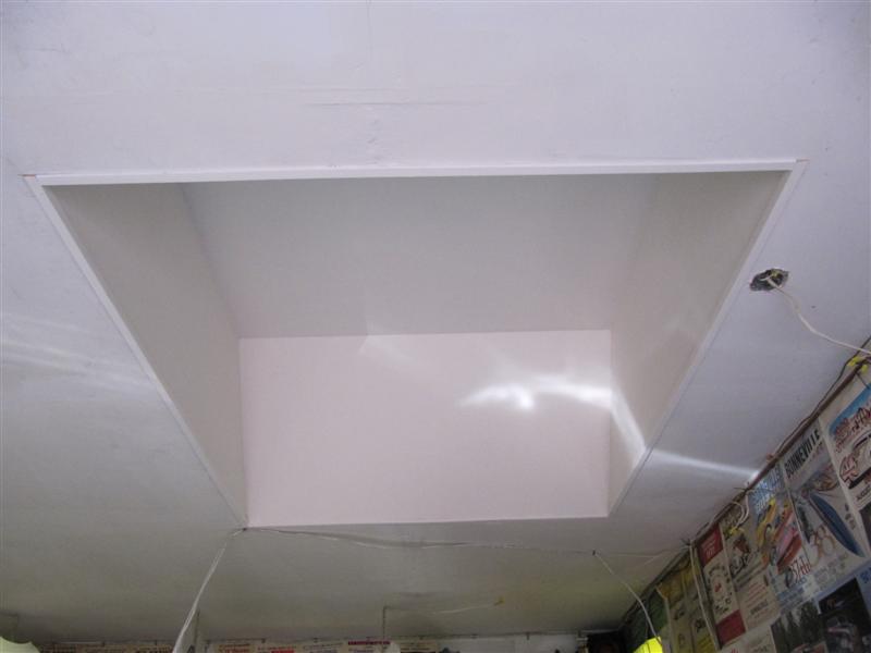

    Raise the ceiling. You'll be glad that you did. garage torque wrenches 002.JPG

    Hello HemiDeuce....Any chance you have more pictures of the ceiling mods you did? I'm considering doing the same. @HemiDeuce
    Thanks!
