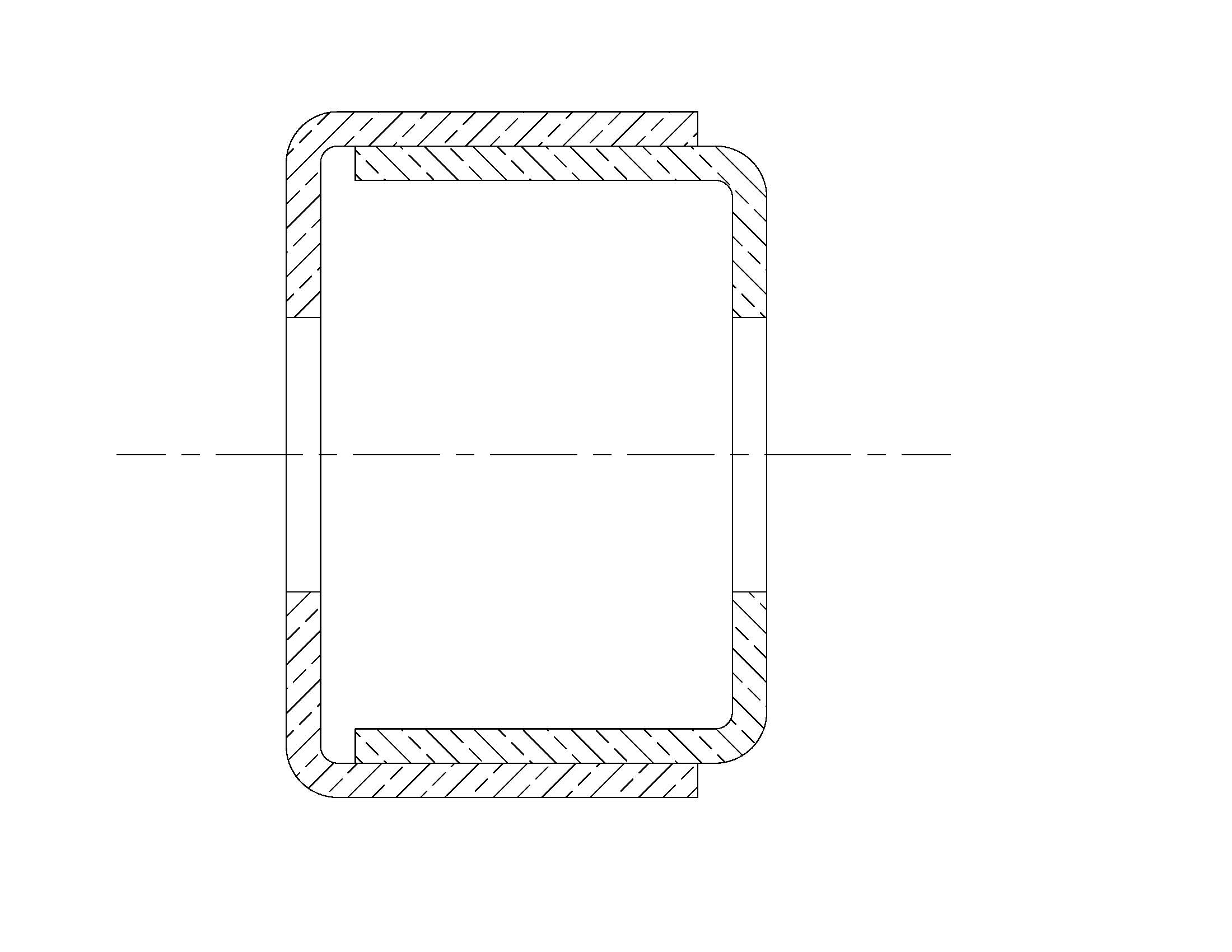

    Cut a shirt cardboard (remember this matl?) template for the inside region. Bob suggests a good way of plating, to strengthen it. I still like the idea of flanging a min. size hole, but this section of the frame is stressed.

    An unreinforced 2" hole in a 5" C-channel reduces it's ability to withstand the forces applied to the frame through the leaf springs. All you're left with is 1-1/2" of frame above and below the centerline of the hole. I wouldn't recommend this approach, not sure why anyone would. Is sleeving and boxing so difficult? I think it's pretty simple, and adds lots of strength and safety.

    Make a "C" shape piece with a hole in it that bolts inside facing the frame C where the new hole will be.

  8. This guy knows what he is talking about! You will only lose about 10% of your strength with a 2" hole in a 5" "C" channel. (The flanges are where the strength is) If you are still worried weld a short piece of tubing of the same wall thickness as your frame channel into the hole.
    Do not weld in plates, or box a short area!!!!!!!!!!!!!! You will form stress risers at the ends of the plates that can start cracks.
    ***uming leaf springs I address the guy that says directly above the axle is the highest stress point, I disagree, it is at the front spring hanger. The spring is carrying half of the weight resting on the rear axle. Where the weight carried by the spring and the weight carried by the rear of the frame converge, (at the front hanger) is the most highly stressed point on the back half of the frame. This is why many medium duty truck frames are tapered from the spring hanger to the rear of the frame.

  10. VoodooTwin
    Joined: Jul 13, 2011
    Posts: 3,453
    VoodooTwin
    from Noo Yawk
    I'm "that guy". The leaf spring is attached to the frame fore and aft. Those 2 points carry the weight that you speak of, not just at the front hanger.
    If cutting an un-reinforced 2-inch hole in a 5-inch frame at the midpoint between these 2 points is safe, how about a 3-inch hole? How about 4-inches? Are these safe as well? I say it's not, just my opinion though. Where do you draw the line? The vertical "web" of the C channel provides the resistance to the moment forces. If it didn't, the frame would be 1-inch tall, not 5-inches tall. Hotrodding is about making cars faster and better. Not faster and worse. If you're going to cut a hole like this, at least be safe and reinforce it with a sleeve, and box it. Just my $0.02.
    Here's a calculator to simulate the point: http://civilengineer.webinfolist.com/mech/bmcalcp.php
    Enter difference values for the location of the moment reaction and tell me where it's greatest. Dead center between the spring hangers.
