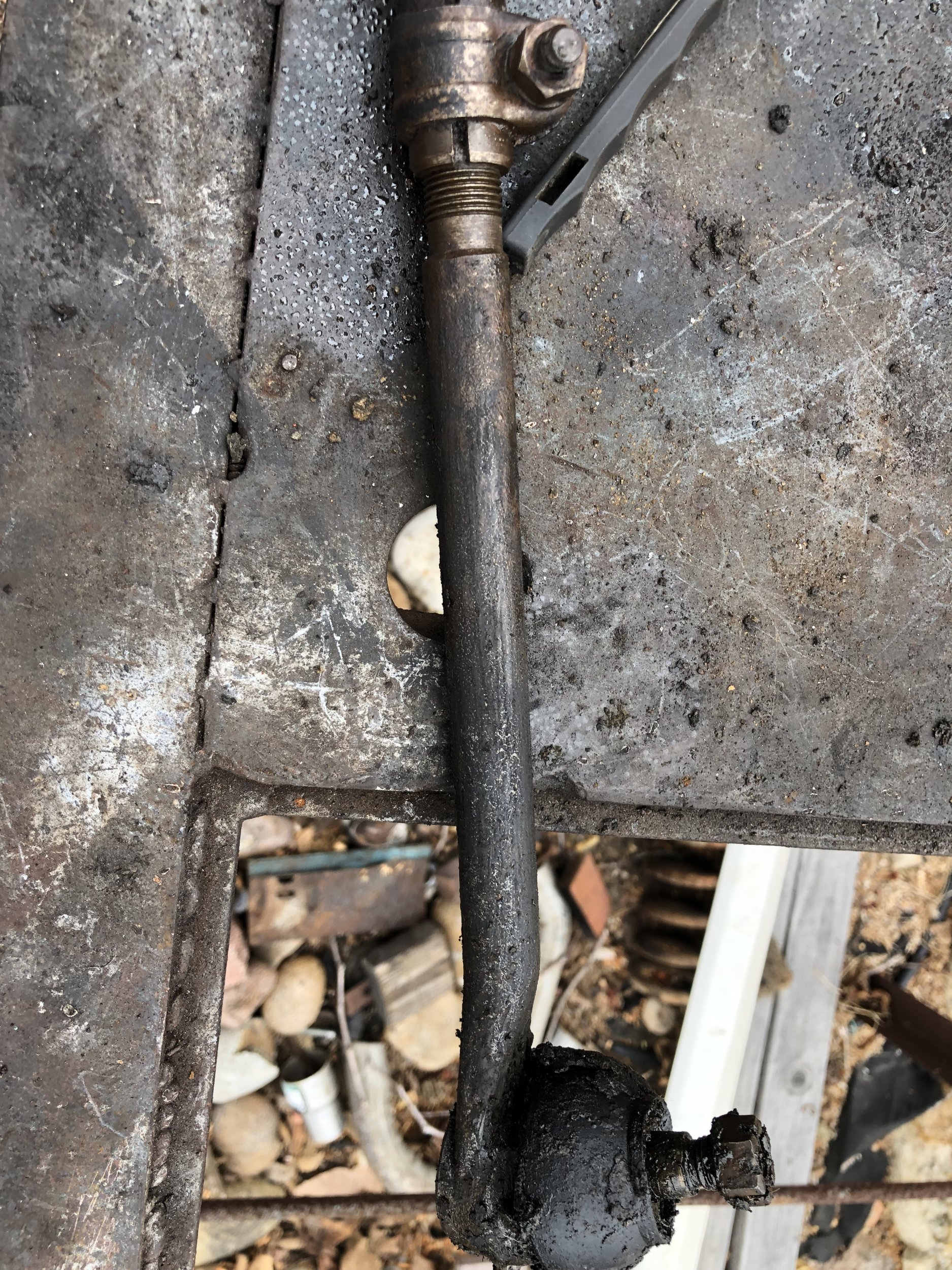

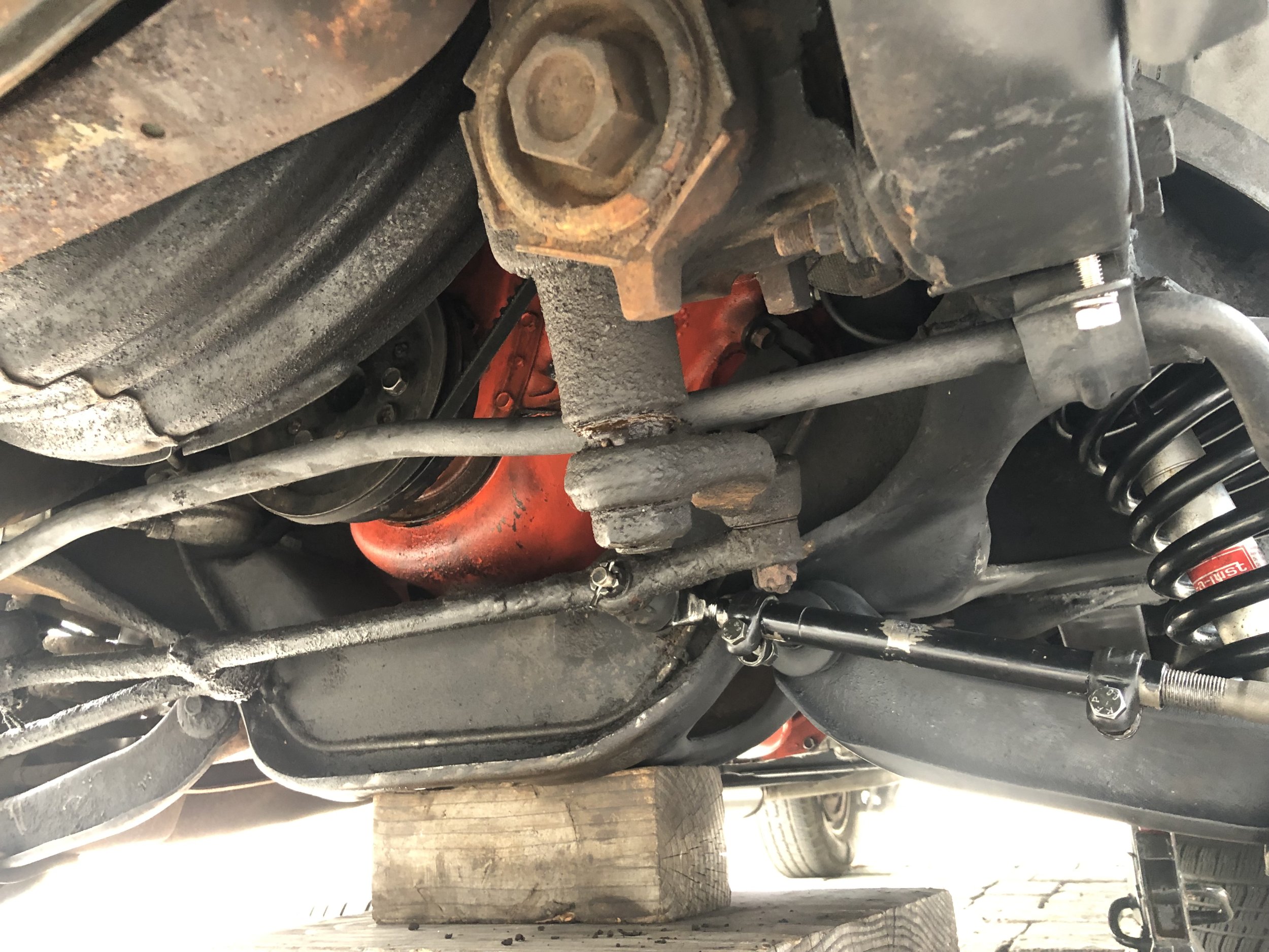

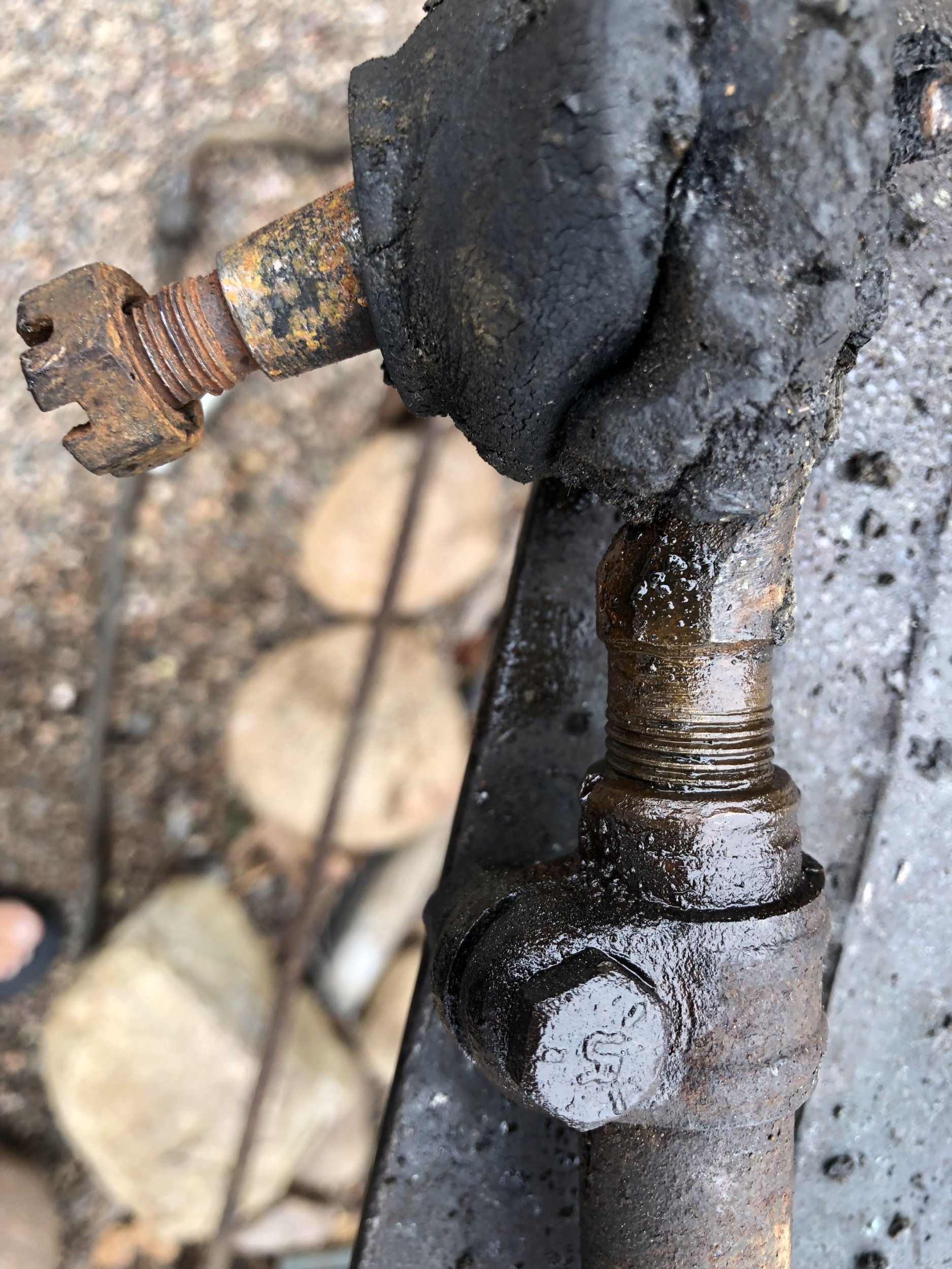

    I took photos of the old tie rod and close ups to duplicate it with the new one. I didn’t measure it unfortunately and the parts had longer threads. The drums look roughly symmetrical positions. Like i said I was going to get an alignment but this would suffice to get me to the alignment shop . This was before my other ride broke down.

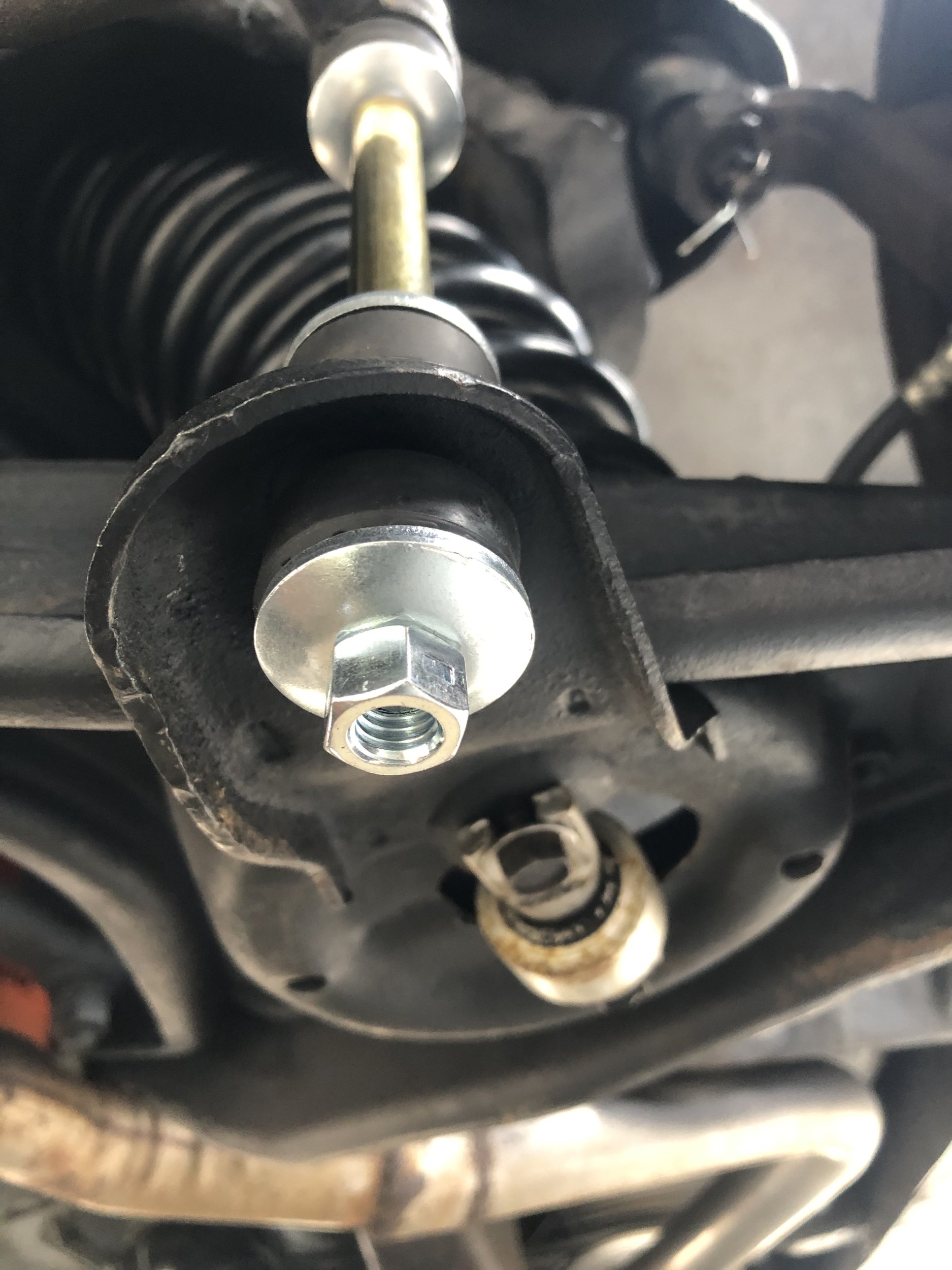

    My next issue is getting the sway bar on . How do I get the nut on? I tried jacking this side up but it started lifting the whole car.
  24. Eth727
    Joined: Jun 20, 2024
    Posts: 255
    Eth727
    I switched the bolt and put it from the top going down. Is that okay? Originally the nut was at the top .
  25. 19Eddy30
    Joined: Mar 27, 2011
    Posts: 3,372
    19Eddy30
    from VA
    Does not matter on Up or down .
    Putting bolts / nuts in / on ,
    Play with all the attaching points , install loose to get all started .
    Some times C clamp , prybare , up & down on jack ,ext, needed to help make it easier. .

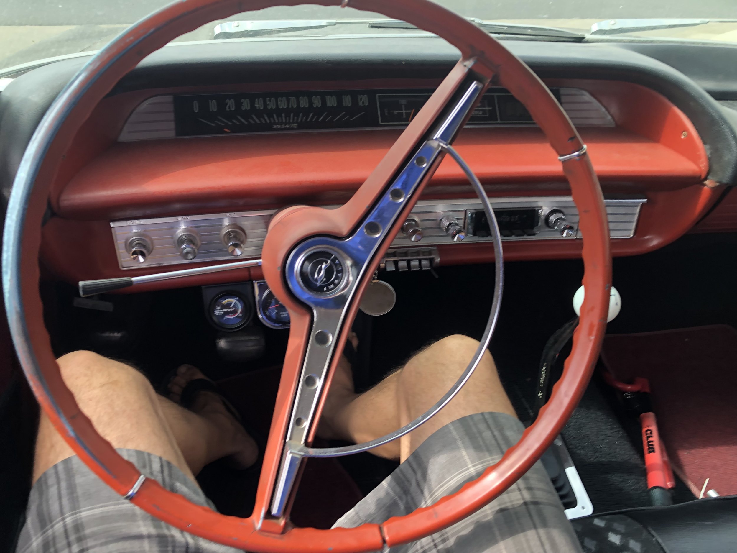

    Okay got it back together and took it for a test drive down the street. The steering wheel isn’t centered but it does drive pretty straight. It does sit higher with the new side. Can I do a quick adjustment to the tie rod to make the steering wheel straight? I know I can remove the steering wheel and adjust it there?
    I think it’ll get me by for 4 drives.
  27. If the steering wheel was straight before I wouldn’t move it
    Put the steering wheel straight then look at the tires. Adjust from there
    This is where 2 strings and 2 jack stands come in handy
    X-cpe, Sharpone and 19Eddy30 like this.

    Yeah the wheel was straight before I started the work. I was going to leave it where it was but had to turn it a few times and lost track where the original spot was.

    From your description you didn't disturb anything from the steering wheel to the steering box to the right side. For purposes of this exercise we can call all that good.
    I would turn the steering wheel to center, hold it there while rolling or driving the car forward a couple of feet to load the steering components. If you have a piece of heavy duty trash bag, a couple of layers of that under the drivers side front wheel will act as a turn plate to allow the tire to move with reduced friction as you make your adjustment. From the position of the steering wheel my gut feeling is you are toed in too far.
    When you go back to finish the other side you might want to check your left side tie rod for the position of the grease fittings. If the ends are like the old ones, right now you have the inner grease fitting pointing at the frame and the outer pointing at the tire.
