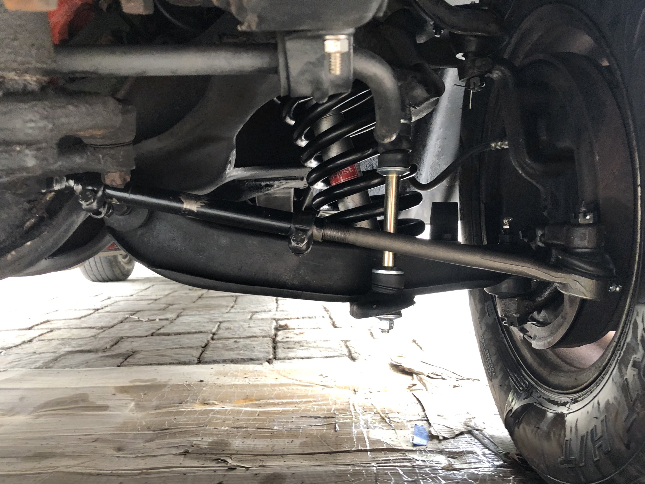

    Yeah I’m pretty sure it’s the tie rod and moving the steering wheel. It was my 1st time. I didn’t even know the short tie rod was opposite thread from the longer side. I saw 2 YouTube videos and didn’t see those guys struggling with the reinstalltion of the sway bar. Maybe that’s a result of the tie rod length?

    Just myself, I’d focus on the side that wa replaced with fresh parts.
    Raise the car, adjust the tie rod end until the wheel was centered again

    My next question is how do I adjust it without removing everything again?

    One caveat, the car has to be on the ground with the weight on the suspension to be measured accurately.
    You adjust it by loosening the clamps on the center sleeve of the tie rod and rotating the sleeve. As you discovered one end has right hand threads and the other has left hand threads. Rotating the sleeve will either lengthen or shorten the tie rod depending on which direction you rotate it. Remember to tighten the clamps when you are done with the adjustment.

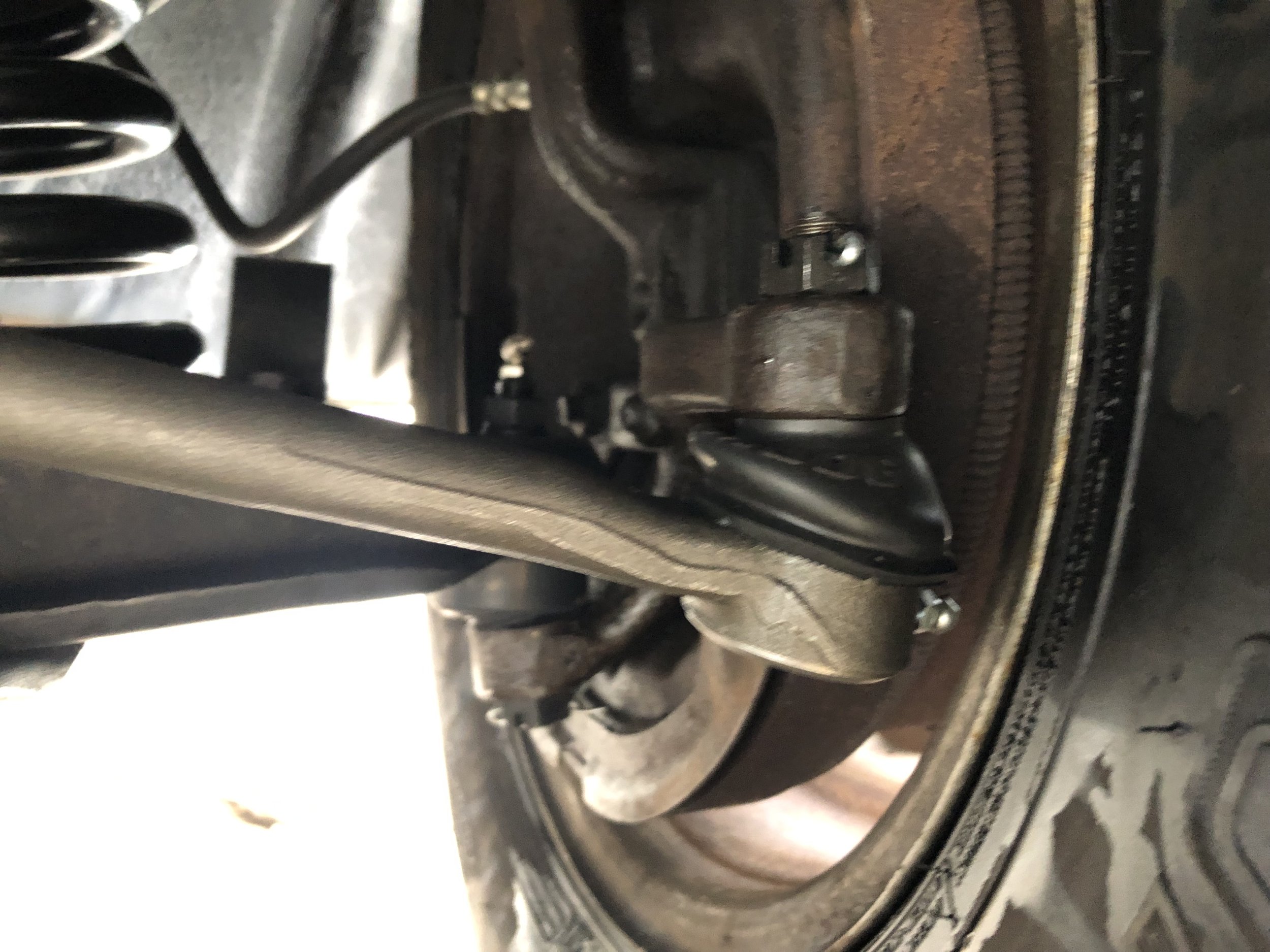

    Shit I just realized I put the tie rods on the wrong side. The long one is on the inner and shorter is the other. That explains why the grease fittings weren’t accessible. Fuck

    Longer tie rod is the inner one. Mines on the outer closer to the tire. The giveaway was the grease fittings not being accessible

    Okay it was definitely the tie rod installed incorrectly. The steering wheel is straight again. Now where in hell is my grease gun? Do the new ball joints and suspension parts come pre greased already?

  15. Budget36
    Joined: Nov 29, 2014
    Posts: 15,013
    Budget36
    Grease them

    Since you had the tie rods in the wrong spot and they're different lengths, it seems like you must not have measured the distances from the tie rod stud to the sleeve on each end (or stud to stud)?
    Seems like that's why your steering wheel is off, and likely your toe. Once you correct your , if you set the toe by turning only the driver's side sleeve I would think your steering wheel should end up straight.
    Measure the other side before you take it apart and put it back together the same length and you'll have an easier time.
