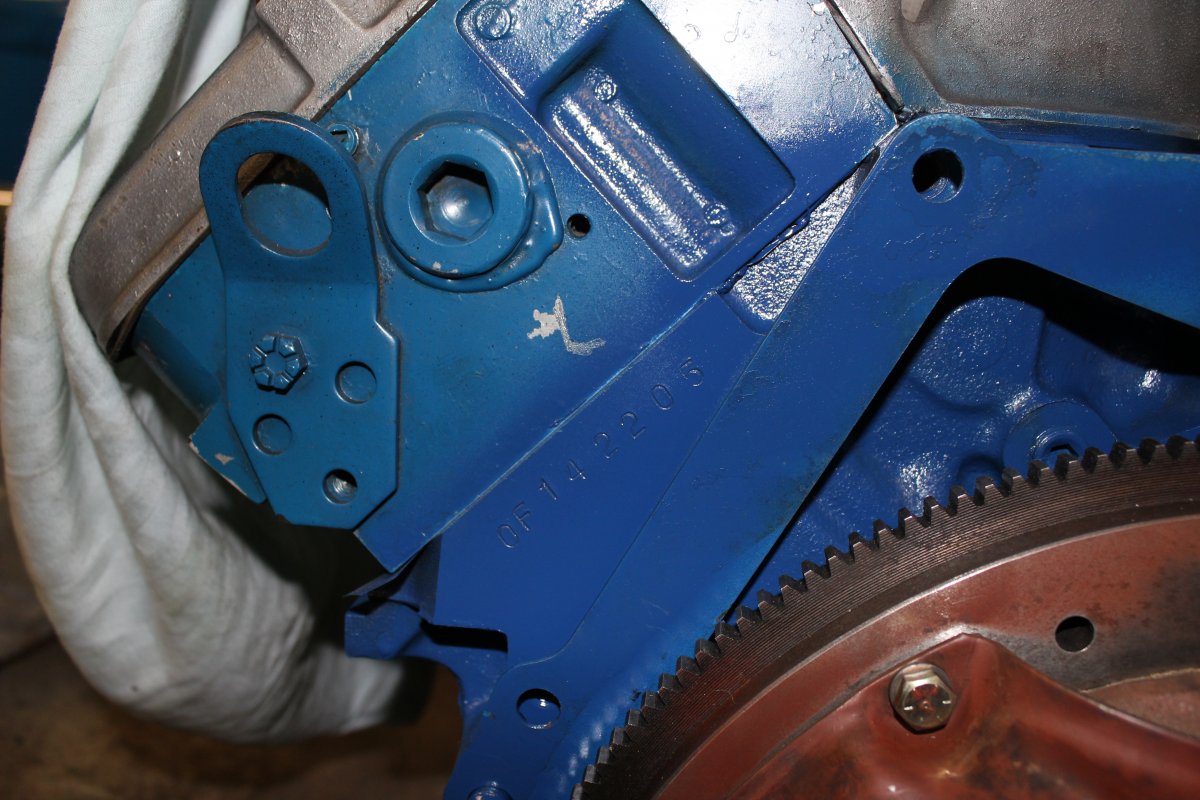

    IMG_2536.JPG Some Fords, mostly hipo's but not all had a partial vin stamped on the left rear of the block just below the cylinder head on flat machined pad. Should look something like this.

  13. So if I find that stamp how can I decide it ?

    Charles pretty much hit it. I have one Hipo block w/ "K" VIN and 3 that are w/o

    I have 2 hipo 289 blocks w/o vin also.
