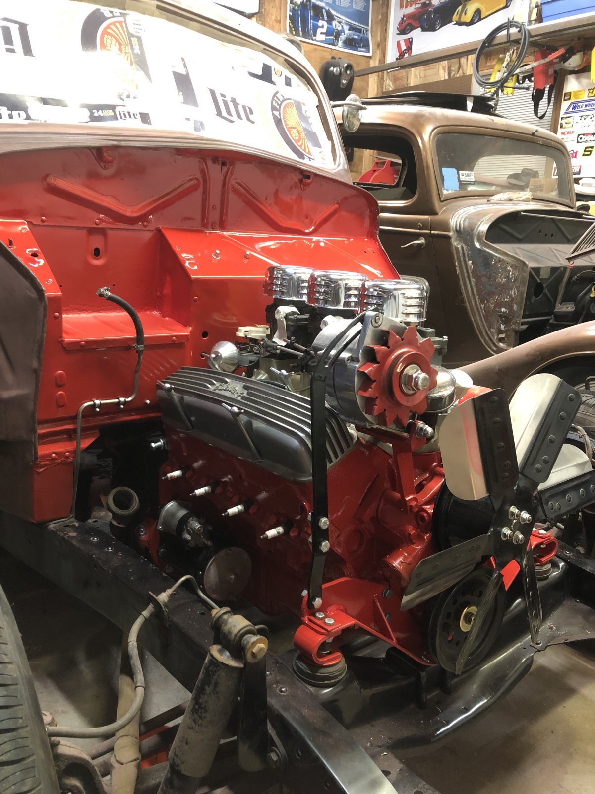

  13. RICH B
    Joined: Feb 7, 2007
    Posts: 5,894
    RICH B
    The pan was close to the U-bolts; but had adequate clearance on the '40 I mentioned. So I can see where the spacers would be needed on a '35-'36 with a flatter crossmember.
