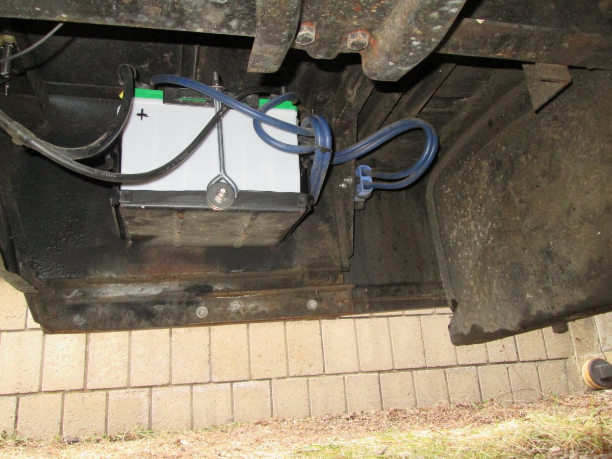

    I am trying to remove the battery with out taking floor out and all on top of it...
    I have a 1961 1 ton Boyertown Ford parcel truck P350 customized battery box where I would have to take all out of seating area floors... lots of work . The battery box came off of a 1940 Plymouth and welding in so in order to take out floor boards must come out..
    But I can get and see the battery box under the truck IF I cut (grind) the front 12 inches or so I could take the battery out and add a side bar .
    Could I wet towels cover the top f the battery make a shield and use a small grinder to cut the metal or I am taking to big of a chance
    Thanks for the info DANiel

    Issues would be hitting it with the cutting wheel. Acid all over you. Fumes from the battery can explode. But to me a fan behind you to protect your breathing and a wet towel would be good. That's only an old mans opinion.

    ANY time you cut and/or grind around a battery you are taking a chance. Wet rags covering the battery and plenty of ventilation may help but still not advisable. I would recommend taking the long way, remove everything properly to access the battery, remove it then modify the box for future battery work.

  20. Plymouth
    Joined: Jan 8, 2008
    Posts: 211
    Plymouth
    Thanks for the Reply s hers a picture of my 40 Plymouth battery box in my 1961 Boyertown P350 Parcel Truck , battery mod 004.jpg the battery fit in perfect but taking out was a a pain SO I had to cut the side out .. Now anybody can replace it if needed it took my @ 6 hours to take the equipment out on top but was worth it .. in the end ..
    Only reason I question is some guys at the junk yard and some mechanics said to use wet towels and a shield I had my doubts and asked the ? here and got my gut feeling answered THANKS. DANiel
