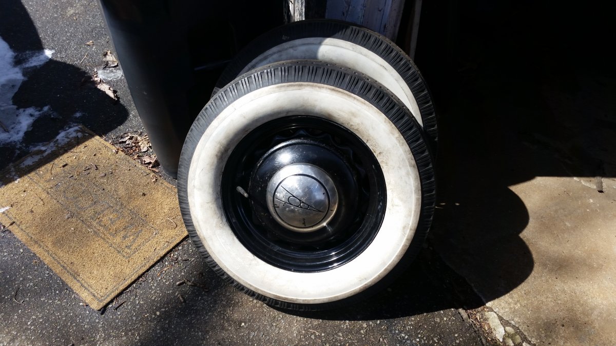

    I am hoping to get my car into the race of gentlemen in New Jersey but they don't want whitewalls- I have whitewalls. Can I paint or maybe shoe polish? Somebody on here must have experimented. . . 20170326_113927.jpg
  2. This is crazy.... I have three sets of whitewalls on three cars. Can't imagine why anyone would ruin a good set! I'd get a set of blackwalls or avoid their gentlemanly race......................
  3. Go to a professional suppler for automotive paint to body shops and they should have something to "paint" the tires black. Don't take a short cut with regular paint or shoe polish.

    what about that spray on plastic stuff that you can peel off later?

  6. Turn the white walls inside. That's what I did and they didn't have a problem. Plus it's free.......

    the tires I have are white on both sides, I didnt know they made those

    Try Plastidip or something similar, and you can peel it off after you are done.

    Clean well and use Krylon satin black on entire sidewall.

    Then turn them to the inside .

    M.E. Miller Tire Co. actually makes tire paint. They have a website and it's listed under tire supplies.

  15. Use some household latex black paint if you are bound and determined to do so.
    High pressure spray will most likely remove it when your ready for whitewalls again.
    If it we me I would sell or trade them for black walls. HRP

    You can spray paint them, but you have to use a satin or flat paint. For some reason any paint with a gloss or sheen will not fully dry when applied to rubber. Flat works best, then you can dress them up later.

    I used flat black Rustoluem spray paint on the raised white letters on the tires of my 50 one year so I could get into the Vintage Torquefest, (no white letters were allowed and I wasn't taking off nearly new tires for the show). 4 or 5 years later, about 1/2 the white letters are white again, after letting Mother Nature do her thing. The tires are no longer worth worrying about, and the current ride they are on wouldn't qualify for any show. Gene

  25. I have used ME Miller tire paint and it works great..

    I still have a quart can of DuPont No.7 tire black. Bought it back in the early 80's to paint out the BF Goodrich white letters on my coupe, and it is still good today. Great stuff, not shiny, just a nice flat sheen.
    It hasn't been on the market in years.
