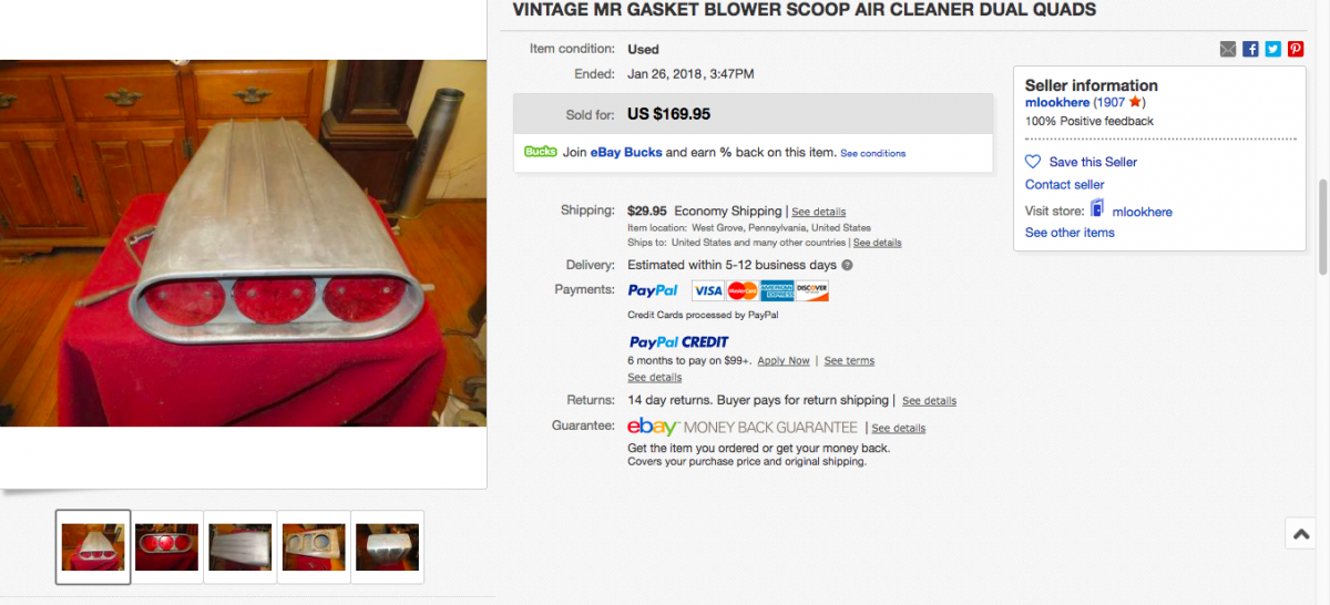

    Screen Shot 2018-01-26 at 3.52.47 PM.png Thank You for all the replies! I feel sort a guilty after folks tried to find me an air cleaner I switched gears. I found a hood scoop that I really like so I bought it! I'll post it! Screen Shot 2018-01-26 at 3.52.47 PM.png

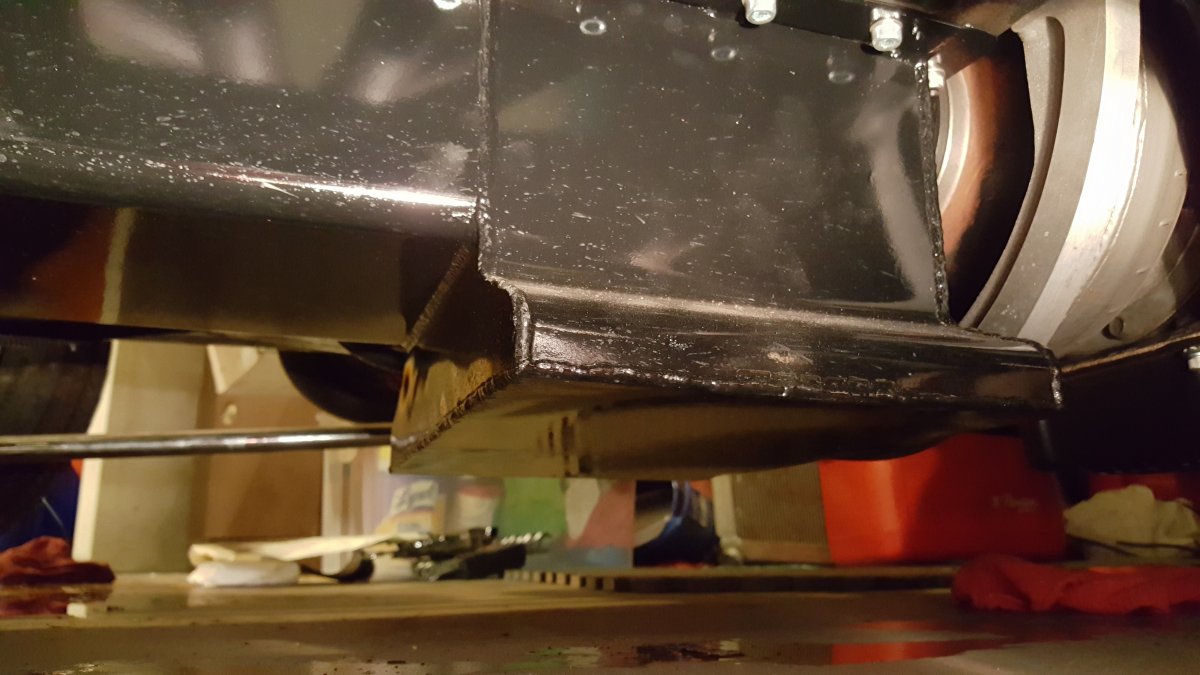

    Here's the original oil pan & the shorter one. The pan was the only thing hitting so no reason to cut anything else off (also used a shorter trans. pan).

    LOL, ok I'm not serious... I hate computers... I can't even get pic's up... Actually I'm taking the advice that my car would look like sh*t with air cleaners shoved under the hood. There's just no room. The '65 Ford one shown about won't even fit... My manifold is a bunch taller than the Weiand, Cragar or one from Austrialia but my distributor would hit the blower if it was lower... 20180126_215321.jpg
  24. Well, that's not a normal hemi oil pan- the bottom of the sump and the bell housing should be about even. And the oil pump pick up should have gone down into that deep sump.
    We really need better pictures if you want better help.
    That manifold of yours is a problem, maybe more than just height.
    If that's a 6-71 blower, I'll bet you have all kinds extra wired spacers up front behind the drive pulley so it lines up with the crank pulley. Or if it's an 8-71 blower (kinda goes with the mega capacity deep sump pan) it might make sense why the distributor is crowded, the 8-71 is 1" longer on the back of the case than the 6-71.
    Here's a 6-71, on a cragar manifold, with a stock 392 distributor housing. More than enough room
    Here's a stock style 392 oil pan to trans relationship.
