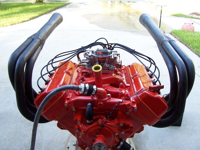

    Don't really know what that is, but it is different. Compare this 392 and you will see were the valve cover is mounted, and it does not have that piece. brads392hemiproject140.jpg

    Yes, I agree on air cleaners sticking out would look goofy! But I found a scoop I like! Hmm, outset drive? I'll research that. I have 3/4" spacers between the valve covers & heads. Got em from Hot Heads. That's why it looks different. The numbers on the block are 392 hemi numbers. Motor came from Big Al's Toy Box....

  9. You need very tall & wide aftermarket valve covers or that spacer to clear tall &wide after market valve train parts
