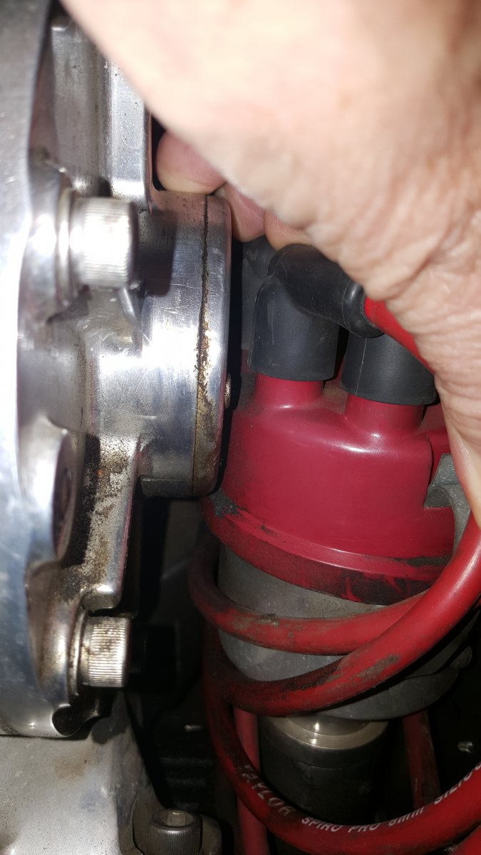

    I'm pretty sure that's a Chevy distributor adapted to the hemi with a spacer. Get a distributor for a hemi and you will clear your blower.

    Whoops, I crossed a line... Chevy distributor? Ah, thank you. I'll check up on that... An original 392 oil pan would. I would have had to shorten it too... It runs great but heats up on hot days. Think I need to go to a pull fan rather that push... Donavan valve covers? I think they are ugly lol...

  10. Yeah - but the minute you start thinking about offset distributors, then you need a firewall that gives the "offset" someplace to go. My bet - he won't have room for it.

    Thanks for all the replies! I'm convinced, Mr Gasket is a no-go... An offset distributor would have to be inside the car, no room... I'll contact Mike when I get the bucks! Bill

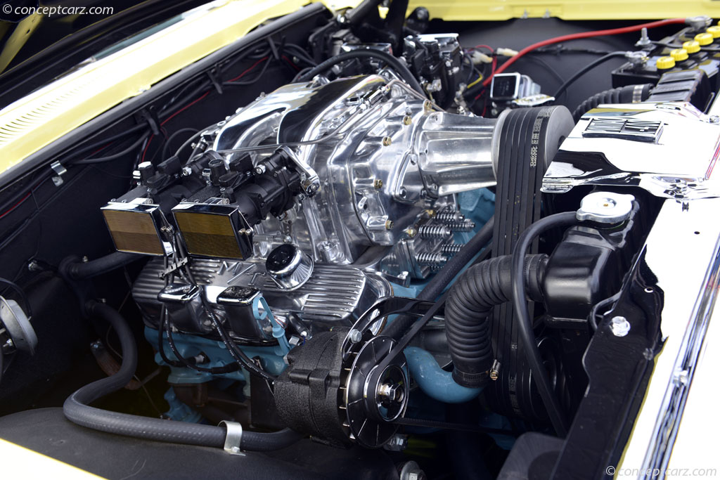

    I don’t think M/T ever actually had that as a catalog item. Pontiac looked to Mickey for “ink”, they back doored what he did with cars, parts and engineering and in return his speed attempts, etc. generated magazine articles. Thompson was to Pontiac what Yunick was to Chevrolet, and in fact at one time Smokey was on Pontiac’s payroll too.
    That manifold was on a Pontiac show car, I think it was the X300 (?), a car that leaked out some of the Grand Prix styling to gauge public reaction.

    It sure looks awesome! And hood clearance is a must in daily drivers that see weather!!!
