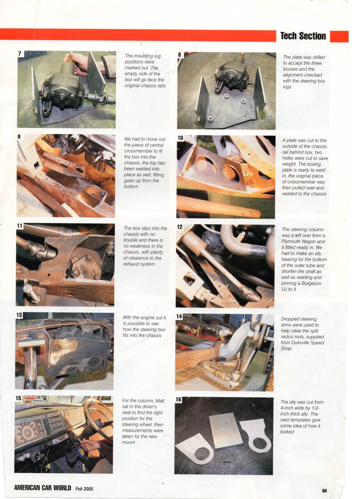

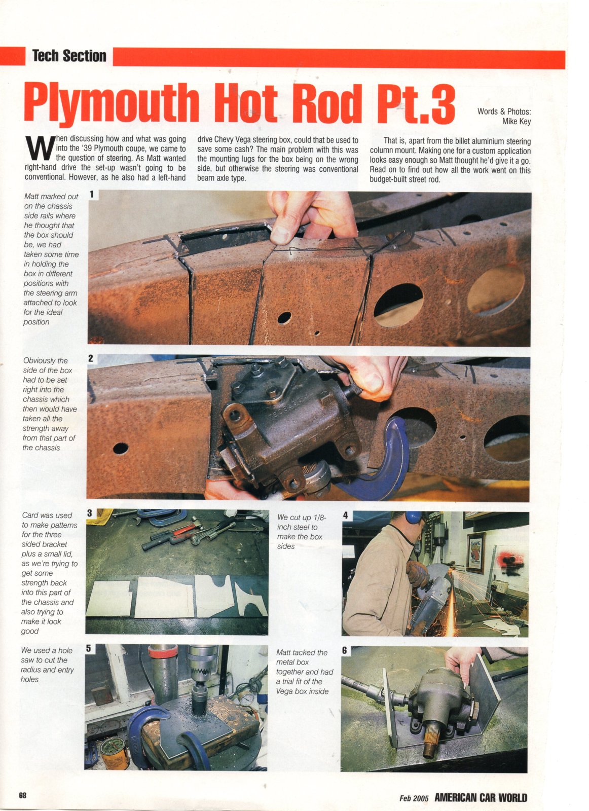

    I deleted this once already second guessing myself . Lol . Love these challenges. I'm going to say no . Edit. I should add perspective is looking at wheel in drivers position and pitman from side 20240120_212557.jpg

    I thought that, initially but when i look at the f1 box it basically looks the same as the f100 box only the other way up. I would definitely need to put a new fill plug in it and probably overfill it with steering grease to make sure it is lubed. I will also be running it in a more vertical position than it is would have been originally
