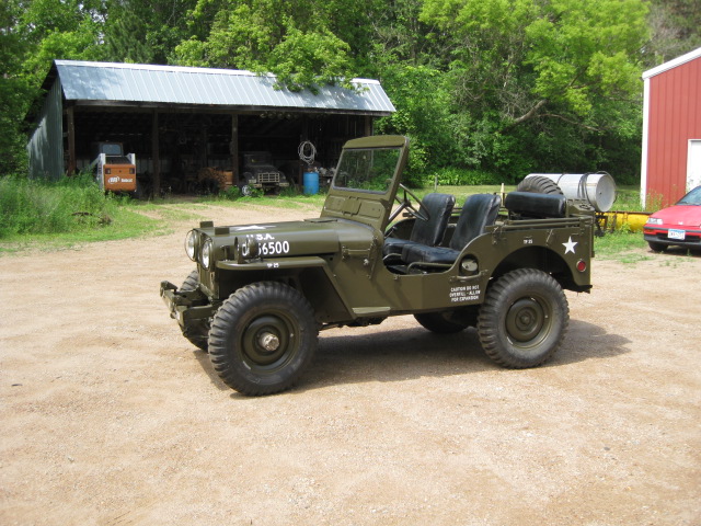

    You are absolutely correct Anthony. The problem is I foolishly bought a gallon of acrylic already. The story is, Its a 52 willys m38 army jeep that is really a good one. rust free, all original under the hood. When I bought it they had just started to make it a high school kids jeep, with roll bar, chrome wheels, black vinyl top etc, and I want an army jeep. It came with all the original wheels, and 1952 dated NDT tires. I sandblasted the rims, epoxy primed, urethane paint, new NDT's, all good. It also came with the letter from the guy they bought it from in 1984 when I am guessing the deal was done from the sunday paper, and snail mail correspondence before Al Gore invented the interweb. The letter brags about the new paint job professionally done, and the new chrome wheels, and new top. I was hoping the pro shop put on pro paint, and if not I figured I could seal it. Funny, Midwest Military near me where I buy parts and OD paint, tried to talk me out of it and buy the enamel version, but my mother didn't give any common sense it seems. Today I bought a quart of DP epoxy primer and catalyst to continue my experiment, but at the same time I am starting to see it will cost less if I dump the new gallon of urethane on the ground and buy some enamel instead of trying to seal bad paint with expensive products. I will use the DP on other projects, nice to have it in stock in the shop, but like every thing else prices are going up on cheeseburgers and paint. The Mastercoat slim mentioned above by Pat is only 42 bucks a quart, that may be the best way out of my corner. Thanks guys for all the response.
    anthony myrick likes this.
  21. rusty valley
    Joined: Oct 25, 2014
    Posts: 4,298
    rusty valley
    I think I have put up these pics before. Its a jeep thing, most wont understand, but @anthony myrick will get it. Here's the day I bought it, and later after I striped of the kid stuff. Spotless clean, the PO hardly ever drove it in 40 years. Top still looked brand new. Still OD green on the under neath floor. Sure wish I got it before they painted it. IMG_0831.JPG IMG_0850.JPG

    Well, finally an update, I guess I move a little slower these days. First a booster for @Pats55 and his product mentioned above, MasterCoat Slim. The product did what he said it would, sealed up my old paint to shoot modern urethane over the top with no lifting issues, and its sand able . Pat was a pleasure to do business with, and even sent me a sample of his rust remover product which is good as well. I had previously bragged that the old paint job was "professionally " done! Well, silly me, lots of issues once I got started on it. The "professionals" had sandblasted the whole jeep without taking anything apart. So, places that didnt get hit, or were hard to access had about 3 layers of paint that I needed to atleast make an effort to feather out. Not trying to make a show car, its a jeep, but still you cant just paint over the last guys mistakes. They did at least do a pretty good prep job, nothing was peeling off , just more prep for me because I did remove some things to do a decent job of it. I removed the hood-fenders-windshield frame-and all the brackets on the outside of the body so there was at least some places to use a sander instead of my fingers. Fact is, there is very little on a jeep that can be sanded with either a DA or an electric orbital, there is just not much that is flat. Then, even the few flat spots, like the sides of the fender wells were warped from the sand blaster so the machine can not sand lumpy surfaces, your fingers do that. I had originally thought this was gonna be a scuff it with scotch pads and paint !!! Been playing with cars for 50 years...should know better ! I also rebuilt the transmission/transfer case, steering box, new windshield , wired it for two tail lights and brake lights, gutted out the "blackout drive" portion of the tail lights and had a stained glass lady make glass lenses so I could wire them up for turn signals. It should have some new canvas seat covers, and a new army top, but Im done for now. Took it to town today for the first drive and a tank of expensive gas, and by golly she just ran down the road so smooth and quiet (transmission was badly damaged by water, and the PO discovered it did not leak if it did not have any oil in it ) , new clean and expensive windshield, Its all good. Time to drive it ! 209C6B34-8164-4BC4-AF3F-89132720468A.jpeg
