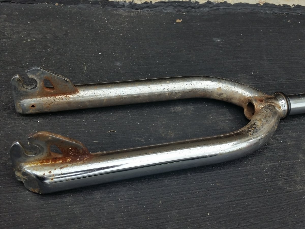

  20. [​IMG][​IMG][​IMG][​IMG][​IMG][​IMG][​IMG]
    So this is how they look after couple days soak in . Not really clean but somewhat out. Maybe need to be there longer? I wipe them and use the wire brush . I kinda expected more clean than this. Lol

    I'll stick with "Evaporust". Your results look similar to mine when I tried vinegar. I think maybe we are using the wrong kind after seeing the results some others have achieved.
  22. I try to find high acid content vinegar and soak it straight.
    Some is very low acid content and doesn't work as well straight.
    Low acid and then 25/75 water isn't much concentration.
    Grazing it with a brush every couple hours really helps too.
    Evaporust is good stuff, but it ain't cheap
