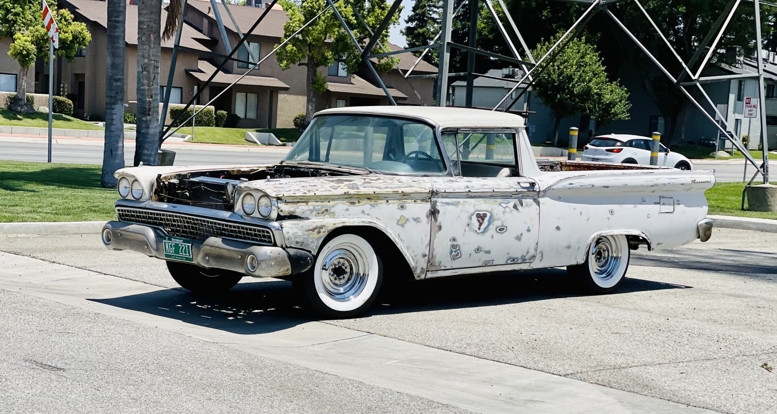

    I have a 352 FE from a 64 galaxie in my ‘59 ford ranchero. I’m upgrading the wiring to a speedway motors 22 circuit wiring harness. It’s great so far, but before I get into messing with getting an alternator or trying to find the right brackets for it, etc, can I just use my generator and voltage regulator that’s already on there??
    I’ve seen the PowerGen alternators that look like generators, but I read several threads on here that say they fail after a while and don’t disperse heat that well. Plus they’re super pricy. Around 400 dollars.
    the new harness has everything all ready for an alternator and all the connections, but if I can keep the generator that’d be great. How do I wire it if I can keep it?
