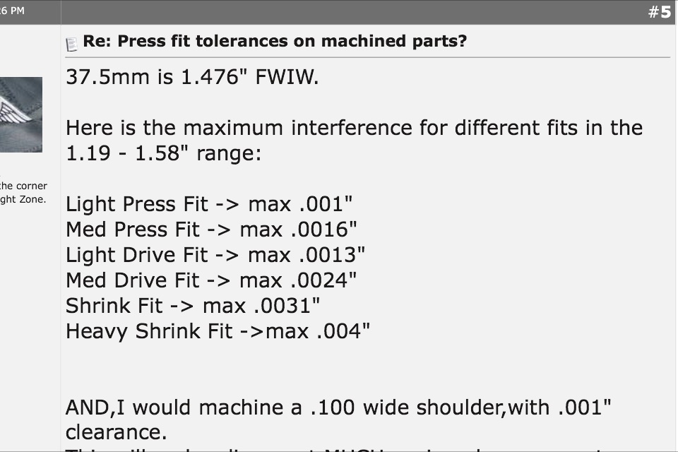

    I copy this from another HAMBer post a While back ,
    Sorry don't know who,
  6. 19Eddy30
