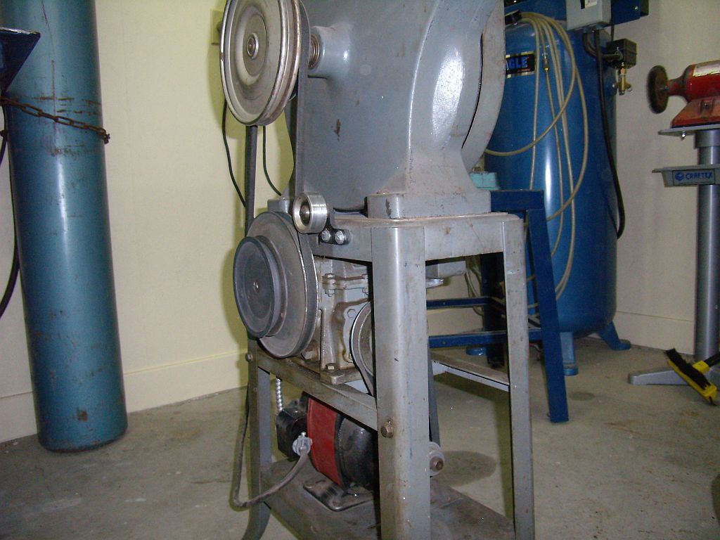

    I have an old ('40's or '50's) Delta Rockwell wood bandsaw that was my Grandfather's. I turned the motor 90 degrees on the lowered bottom shelf. There's about a 3:1 reduction in pulleys from it to the input of a 20:1 gear reduction box, mounted to a simple angle iron frame between the motor and the saw. Two sets of pulleys give about 1.5:1 over/ under from the gearbox output to the saw. Wavy set 18 tpi carbon steel blades cut 18 gauge or thicker steel just fine. 10 tpi is faster for 3/16"+ thickness.

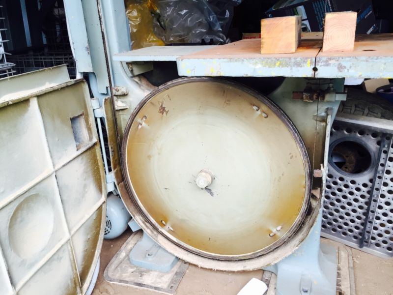

    Revive an old thread.
    I just bought this old girl.
    It has a timber cutting blade but I will change to metal cutting.
    Ill try to cut 3/4" mild steel.
    It has a 3 phase 415 volt motor.

  29. That's a serious saw. I think it has a 36" throat. Since you're an electrical technician, I'm sure you're sure you have 3 phase where you are gonna use it, or just change out the motor and rewire the starter to single phase, not a big deal. It would help to get a motor with slower rpm. But you should read this entire thread, and take note of all the info about blade speed. Unlikely that this saw has enough pulleys to slow it down enough to make it a practical metal saw. Just physics. A lot of wood cutting band saws cut around 1500-3000 feet per minute, metal cutting band saws have a gear box that reduces the speed of the motor (but maximizing torque) at around 150-300 feet per minute. Big difference.
