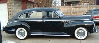

    Saw this project car on craigslist. You guys think it could be chopped and made into a sedanette fastback look?
    Granted anything can be done with money, tools and know-how, but for somebody with somewhat limited resources would this be too crazy to attempt? Also wouldnt want to ruin a perfectly good car....

    Save your money, if you want a sedanette buy a sedanette. They are not that rare.
    That car is the better looking of the 2 sedans they had that year, I think it looks good as it is.
    You are right, anything is possible given enough time, money and talent. But if you took that car to the best custom shop in the world they would tell you what I just told you - if you want a fastback, go buy one. It will be better and cheaper.

    You're the guy with the Cadillac. I remember some of your questions. If you want to know what it would be like to fix up that Buick take your Cadillac experience and multiply the h***les and expenses X 5. If you want to know what it would take to turn it into a sedanette multiply X 10.

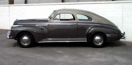

    The 1941 Buick Special (Series 40B) was built in both 2 and 4 door fastback body styles. The Century (Series 60) was also built in the that style, but Centurys are fairly rare. Production numbers for the Speial 4 door version exceeded 100,000 units. I have seen several of those cars over the years.
    The GM "B" body was shared with Olds, Buick, Cadillac and fastback versions of all were produced. They are out there.

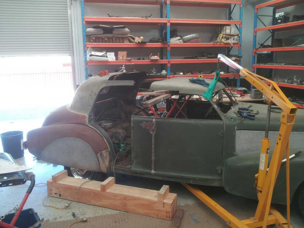

    Of course it can be done. But this is coming from a guy that is building a custom truck that consists of a 1941 Ford car frame. A 1952 F-1 truck cab that has been chopped and channeled and has had a 1941 Ford car front clip modified to fit. But all of theses parts were also destined for the junk yard before I salvaged them....
    To make that Buick into a Sedanette is going to take some serious work. And I'm not even talking about trying to make it look like a stock fastback. You will have to do a lot more the that big **** rear end then just lay down the back gl***. There will need to be some serious section work done to get it to flow right.
    If you want to build a custom like the Olds pic posted( which I have seen before and really dig!) then I say go for it. Otherwise it might be time better spent starting with something else.
    Not to hijack but here are a couple of pics of what I am doing. Almost looks like Old man Ford built it that way.:)

    The Buick is worse than your Cad was when you started, and you didn't try to turn it into a 2 door, and Buick parts are only slightly easier to get than Cadillac.
    George Barris didn't start out building full customs and neither should you. Work your way up to it starting with smaller jobs. Don't overmatch yourselves.
    If you ever read any stories about professional customizers and guys who have built dozens of cars, they usually start out with the best car they can find or the one that is closest to what they have in mind. None of them would start with a 4 door car if they wanted a 2 door any more than a chef would try to make a pie out of a cake mix.
    I don't care how rare they are. You could drive from coast to coast, buy a car that cost $5000 more than that one, and still have less time and money in it, than turning a 4 door sedan into a 2 door sedanette.
    The funny thing is the 4 window sedan is probably just as rare as the sedanette. By far the most popular body was the 6 window sedan. The 4 window is sleeker and better looking too.
    If you built up that car with a completely stock, unchopped, mildly modified body but lowered, you would have one of the sharpest cars around and just as cool as a sedanette.
