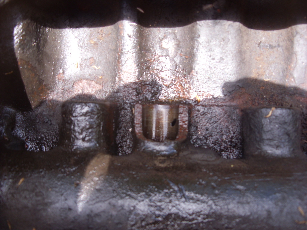

    Broke a lifter bore. Can this be welded and will it work ? I have the pieces to put it back together.I would like to find a shop in Nor Cal or Oregon to fix it. Thanks:confused:

  3. I haven't done it but if it were my block I would surley be trying to fix it unless I had a line on another.
    it is going to invlove being welded and bored, perhaps bored and sleeved. You will have to index off of another lifter bore to get your spacing correct. Correct spacing is critical.

    i dont think that can be fixed.Never heard of a save that involved.

    Heo2
    I saved a lifterbore on a race harley one time
    silver solder it if i remember corectly
    Dont remember though how it was constructed on that engine

    I have seen aluminum blocks reparied when that happened. I guess an iron block can be repaired. Might not be cheap.

    That one o would bore out and sleeve with a sleeve
    thick enough to hold up and solder the sleeve to
    the block and dont weld the piece back
    if you have to farm it out i doubt its cheaper than

    I would counter bore it & put in a bronze bush....Just me ...Shawn

    Camm, that is kinda what I was afraid your pic would look like...:(
    If you think you want to fix it I'd recommend installing a press fit sleeve with at least a 1/8" wall thickness. Don't forget that you also have to have a window to intersect the oil galley.
    I may have found a main cap for you but I think the lifter bore repair will be expensive.

    I agree with 73RR. Bore and sleeve.

    I would "V" it out on the outside, install an old lifter in the hole for centering, weld up, ream out install sleeve with what 73RR recomended for galley hole....................................

    Forget about welding the broken piece back on. Like mentioned above, find a REALLY reliable race engine guy that will sleeve the lifter bore. I would never weld in that lifter galley, it will cause all kinds of heat issues.

    Bet you can get that bored and sleeved for less than a hundred bucks.

    Yep..... the question isn't if it could be fixed, it's more of a question of how much money ya got haha

  22. The lufter bores on a hawg were aluminum, they were fondly called mushrooms and bolted on. Probably a little easier to repair than the cast iron hemi.
    I still believe that the hemi block is savable especially being that the piece that broke out is still there. it is just a matter of how involved someone wants to get and if there is a replacement block hiding in the wings.

    I have fixed stuff like that...and it's alot easier than you might think. I would stick a lifter in the hole, and then GAS WELD, using a plain steel rod, around the lifter. No worries about cracking the block with something like that.
    Build it up thick, and then simply have it bored and bushed when you're done. If you're running a solid lifter, you may not even need to follow through with that step. I did a similar repair to a 426 Hemi block years ago, and never had a problem with it.
