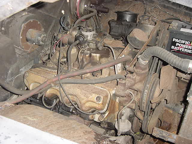

    I have a few questions for the Chrysler people on the HAMB. I'm looking at this engine and trans for my lakes modified project and I could use some help. Can you tell me if it's a 301 or a 331? Also, I would love to know if aftermarket stuff like intake manifolds exist. The engine is in a 1955 Windsor 2 door if that helps you at all. I'm not so worried about hopping up the engine performance wise because the car will be so light to begin with, rather I would like to just make it look a little bit more performance oriented. What do you think?

    its the poly headed beast. do i search for poly vs hemi and youll find what your looking for i think

    That's an old (1954?!) 240 ci dodge engine i think, poor of hp and not a lot of perf parts.

    I think it's a poly engine. I would do some research because I think you can install hemi heads on it without much work.

  11. scrape the crap off of the rail in front of the valley pan and read me the numbers. they tell you the year and size. there are a few parts available , but not much. hemi heads might fit on that motor, depending on a few things. david

    It is a 301 rated at 188 horsepower @ 4400 275 ft lbs @2400
    that 301 will take the Hemi heads 56 are considered best 55's are good too! there are still bonneville records standing with the 301 with hemi heads, fell into the 5.0 litre fim record book.
    see some rare poly parts and they run fine as is for a cruiser

    Build a log manifold for three or four two-barrels (you could even *gasp* use something other than Strombergs!). I have an article that I can email you if you need it. Fabricate some headers (that's fairly self-evident and has been hashed out here a time or two) and check into getting a warmed-up cam for it. You could mill the stock heads, too, for a bit more compression. Somewhere here I have a chart as to how much you can mill various heads up to '58. I'll dig around a bit. Those valve covers are bitchin' and I'd keep 'em. That's uniquer (izzat a word?) than a Hemi!

    Engine Bore & Stroke: 3-5/8" X 3-5/8"
    Engine Displacement: 301.1 Cu. In.
    Compression Ratio: 8.00:1
    Taxable Horsepower: 47.02
    Horsepower: 188 @ 4,400 RPM
    Torque: 275 Ft. Lbs. @ 2,400 RPM
    '56
    Engine Bore & Stroke: 3-13/16" X 3-5/8"
    Engine Displacement: 331.1 Cu. In.
    Compression Ratio: 8.50:1
    Taxable Horsepower: 46.51
    Horsepower: 225 @ 4,400 RPM
    Torque: 310 Ft. Lbs. @ 2,400 RPM
    '56 with a 4bbl manifold option
    Compression Ratio: 9.00:1
    Horsepower: 250 @ 4,600 RPM
    Torque: 340 Ft. Lbs. @ 2,800 RPM
    You could easily hot rod it I'm sure, the '58 354 Polys were total monsters, maybe you could find parts from one of those and stick 'em on the 301 block.

    All the Chrysler Hemi intakes will fit. The 3X2 set-ups are rare as hell. 2X4 everywhere.

    I think I have only seen one Chrysler hemi intake. They were not popular because if you went to the trouble to put in a Chrysler hemi you wanted all the power you could get. I was told that maybe only a hundred or so were produced. Maybe less.The hemi intakes will fit on the corresponding polys. A Dodge 315 hemi intake will fit the 315 Dodge poly, etc. A Chrysler 6X2 will fit your engine. A Dodge or a DeSoto will not.Most all early Chrysler intakes interchange. You can not switch manifolds between brands.I.E. Dodge to Chrlsler,etc.Hope this helps
