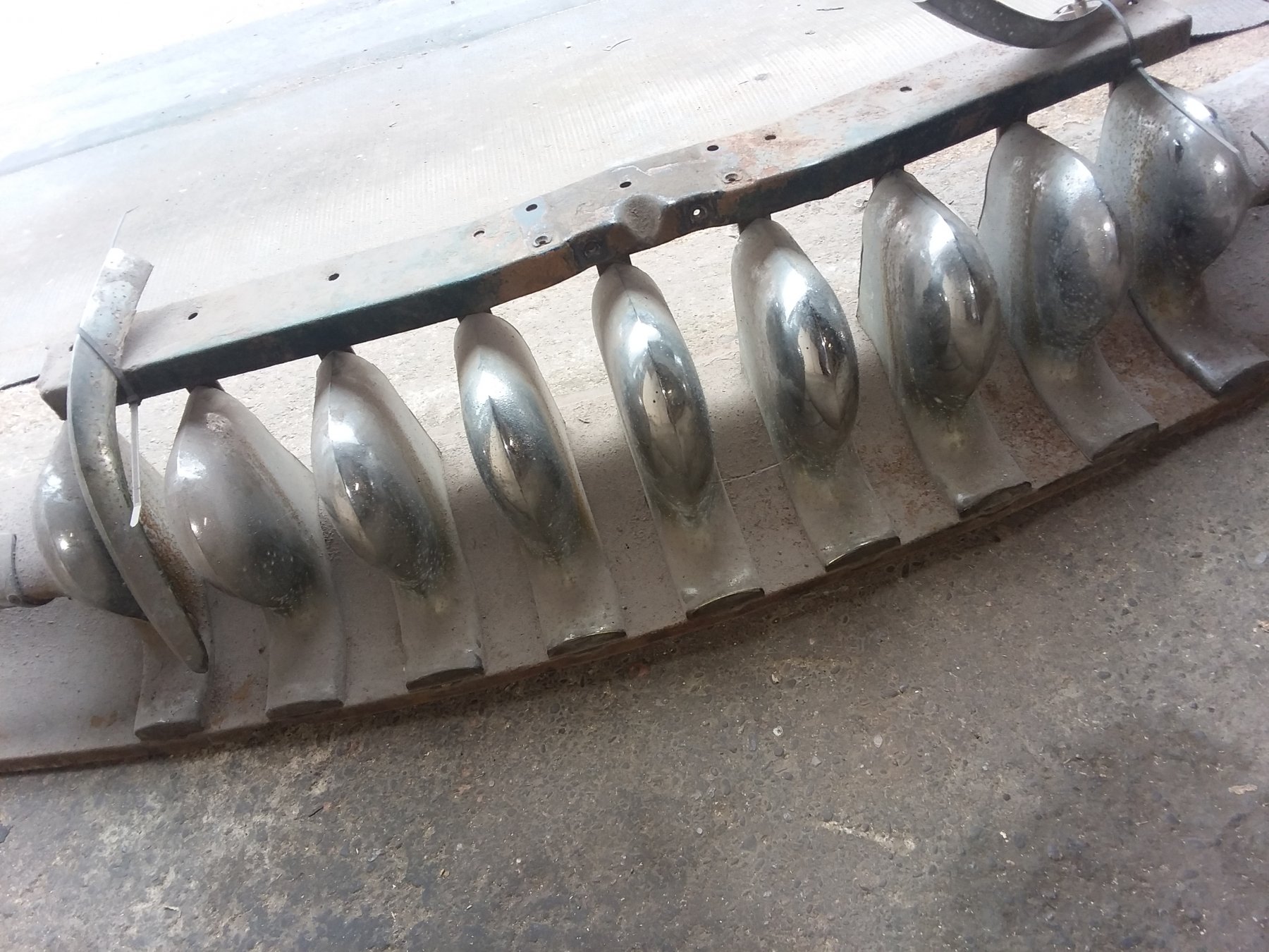

    Yes you can make an 11 tooth from a 9 tooth grille. All the center teeth are the same between each, but every tooth is different, one center and then right and left doing out. I had the each part number but its been a while since I looked at it. Let me see if I can find that.

    This should help you, and anyone else looking for, or at Desoto Grill Teeth from 51 to 53

    That post by Crash Vegas is excellent info. I remember when I had the grill apart for my 51 I had to sort out the teeth out of the 52 Desoto grill to get each tooth in it's correct spot and each one only has one spot. I didn't find the outside teeth from a 53 but the guy I sold the car to finally did.
