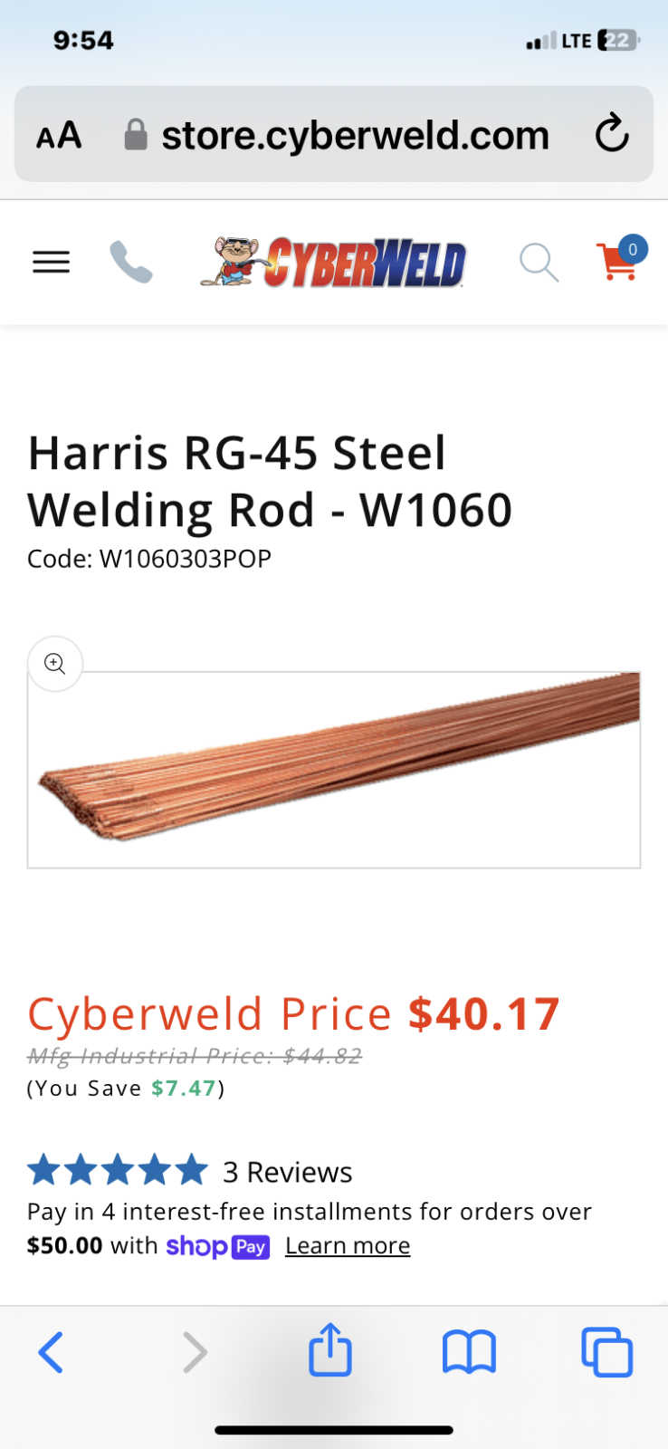

    ER70 was mentioned for rod. RG45 is much better if you are going to work the metal any amount while it is
    still hot. (hammer welding)
    If you are using Bondo, it won't matter.

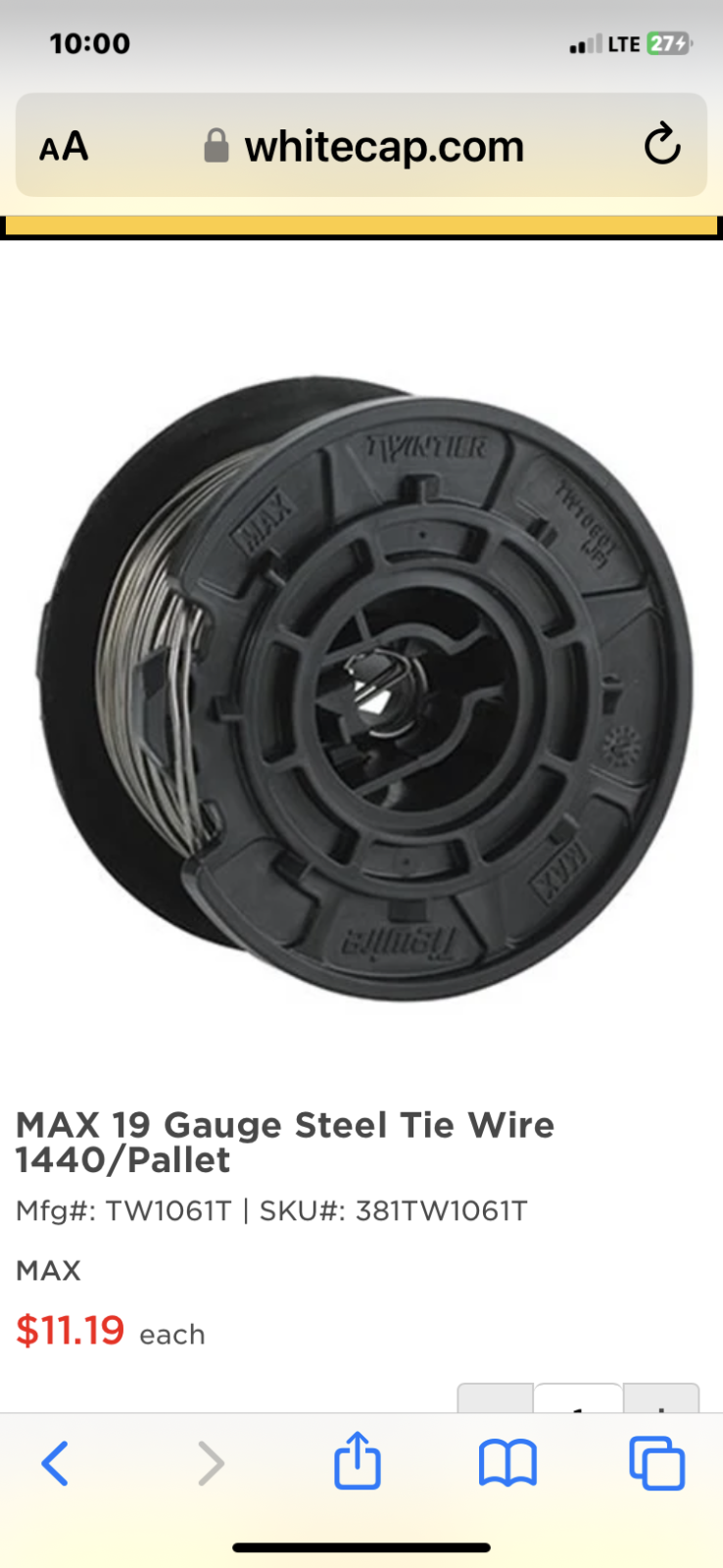

  17. That’s where the rebar tie wire comes in.
    It’s 1006 or 1008 steel with 40-60 tensile strength. 16,19,21 gauge. Just plain Black annealed not PVC coated Stuff.
    3lbs of rg45
    3.5 19ga tie wire
    The stuff on the spool is for rebar tie guns and is rated to meet engineering specs.
    The stuff without the spool is a little bit looser on quality of wire specs.
    If you’re going to do a lot of sheet metal welding in shorter runs, maybe saving $30 ain’t worth it and you want the sticks. Maybe you’re tripping over some rolls

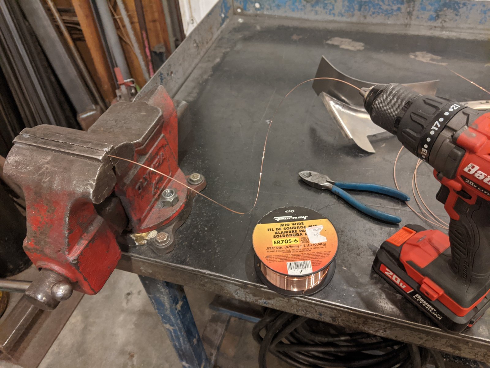

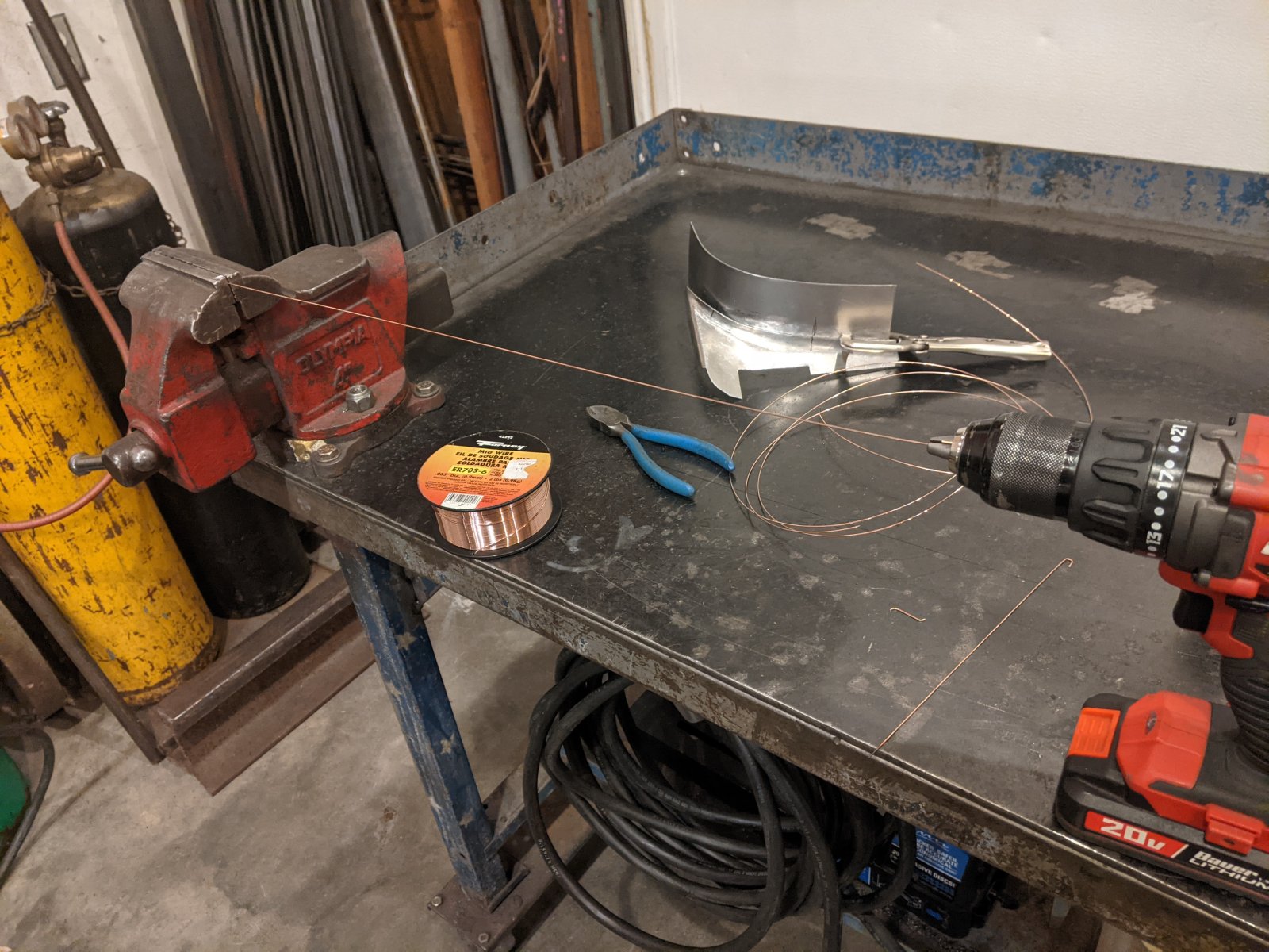

    I posted this in one of my build threads:
    sneaking a little tip in here,
    when tig welding body sheet metal I typically use .035 mig wire.
    to make it a little easier to handle and feed,
    I unwind a couple coils from the spool,
    stick one end of the wire in a cordless drill
    and the other end in a vice,
    give it a spin under tension
    and voila, nice straight easy to feed .035 welding rod

    Thanks for that tip Paul. I use a lot of mig wire on thin metal myself, and never thought of a good way to straighten it.
    Paul likes this.
